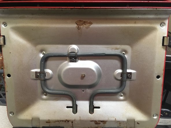

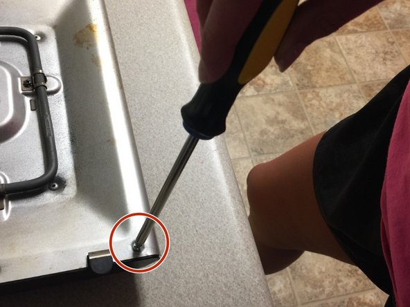

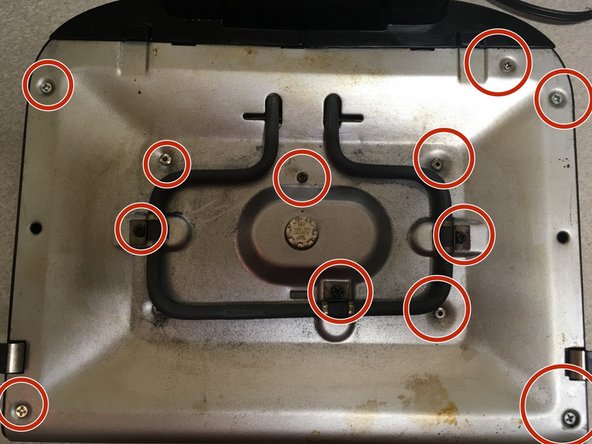

  4. George Foreman Wire Repair: crwdns2935265:04crwdnd2935265:01crwdnd2935265:03crwdne2935265:0 George Foreman Wire Repair: crwdns2935265:04crwdnd2935265:02crwdnd2935265:03crwdne2935265:0 George Foreman Wire Repair: crwdns2935265:04crwdnd2935265:03crwdnd2935265:03crwdne2935265:0
    • Underneath where the plates sit you will see a coil and 12 screws holding the base plate in place.
    • Remove the 12 Phillips head screws on the bottom plate with a #1 Phillips head screw driver.

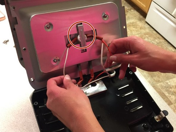

  5. George Foreman Wire Repair: crwdns2935265:05crwdnd2935265:01crwdnd2935265:01crwdne2935265:0
    • After unscrewing the screws, lift off the base plate.
    • This is where you will see the wires.

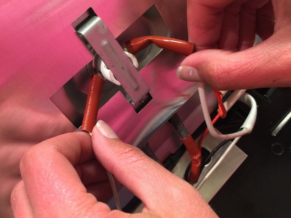

  6. George Foreman Wire Repair: crwdns2935265:06crwdnd2935265:01crwdnd2935265:02crwdne2935265:0 George Foreman Wire Repair: crwdns2935265:06crwdnd2935265:02crwdnd2935265:02crwdne2935265:0
    • Re-establish the disconnected or loose wires by pushing them back into the point of connection.
    • Push the wires into the connection center on the bottom of the plate until you can't anymore. This is how you know they will not come loose again.
    • Make sure to keep the wires separated so they do not touch and become tangled to avoid sparks and electrocution.
