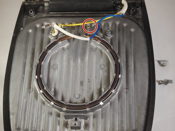

  4. George Foreman GR-20 Disassembly: crwdns2935265:04crwdnd2935265:01crwdnd2935265:02crwdne2935265:0 George Foreman GR-20 Disassembly: crwdns2935265:04crwdnd2935265:02crwdnd2935265:02crwdne2935265:0
    • To measure the resistance of the heating coil, disconnect the blue wire from the heating element.

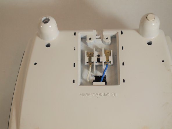

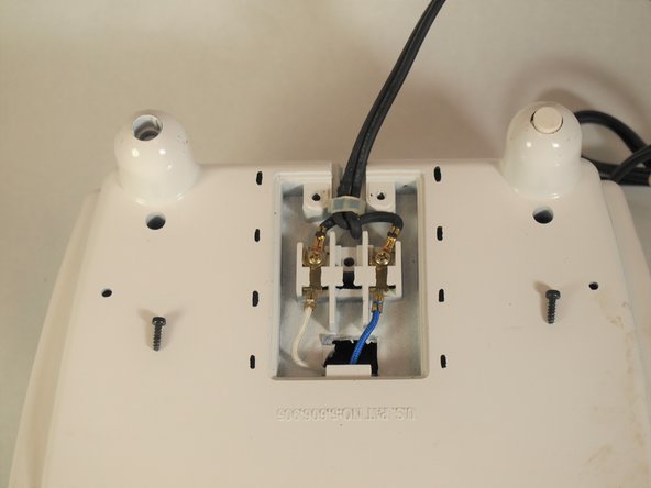

  8. George Foreman GR-20 Disassembly: crwdns2935265:08crwdnd2935265:01crwdnd2935265:02crwdne2935265:0 George Foreman GR-20 Disassembly: crwdns2935265:08crwdnd2935265:02crwdnd2935265:02crwdne2935265:0
    • To remove the power cord from the device, remove the two Phillips #2 screws keeping the power cord and the blue and white wires connected.
  9. George Foreman GR-20 Disassembly: crwdns2935265:09crwdnd2935265:01crwdnd2935265:01crwdne2935265:0
    • After removing the screws, slide the blue and white wires out through the gap.
    • You will now have access to the underside of the grill.

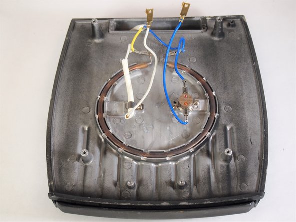

  10. George Foreman GR-20 Disassembly: crwdns2935265:010crwdnd2935265:01crwdnd2935265:02crwdne2935265:0 George Foreman GR-20 Disassembly: crwdns2935265:010crwdnd2935265:02crwdnd2935265:02crwdne2935265:0
    • Remove the two Phillips #2 screws attaching the fuse to the grill.
    • Remove the fuse from the grill.
  11. George Foreman GR-20 Disassembly: crwdns2935265:011crwdnd2935265:01crwdnd2935265:01crwdne2935265:0
    • Remove the Phillips #2 screw from the white wire.
    • Remove the white wire from the grill.
