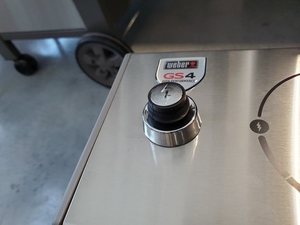

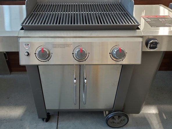

    • Be sure the grill is turned off before beginning this guide.
    • Remove all of the control knobs.
    • The amount of knobs may vary depending on the grill.

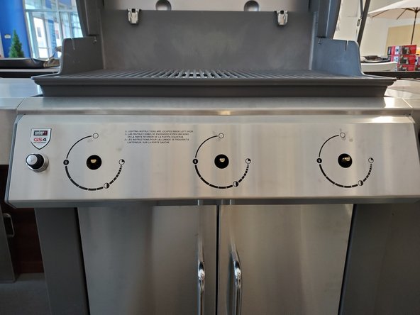

    • Remove the two 19 mm screws below the control knob panel using a Phillips #3 screwdriver.

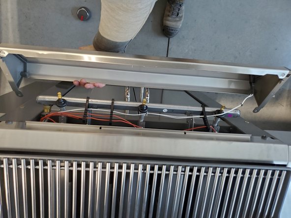

    • Push up on the front panel, and pull it up above the grill.
    • Potential for device damage: The ignitor is connected to the front panel, so do not pull too hard.

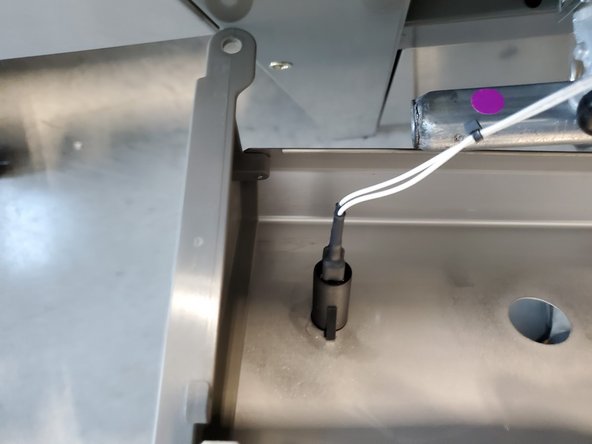

    • Disconnect the cables from the ignitor.
  5. Genesis II CSS-315 Ignitor Replacement: crwdns2935265:05crwdnd2935265:01crwdnd2935265:01crwdne2935265:0

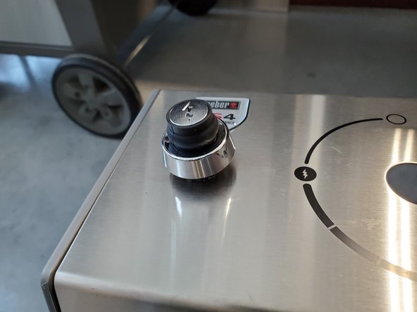

    • Put the new ignitor into the socket.
    • Press down evenly until it is secure.

    • Make sure any and all cables are separated from the fire box (the bottom of the grill).
    • Slot the panel back on the grill and then push downward.
    • The fire box is the part of the grill that gets really hot, and this can damage the cables.

    • Make sure the holes match and reinsert the screws from Step 2 using a Phillips #3 screwdriver.
    • If the holes do not match up, you may have to gently push or pull the front plastic panel.
  11. Genesis II CSS-315 Ignitor Replacement: crwdns2935265:011crwdnd2935265:01crwdnd2935265:02crwdne2935265:0 Genesis II CSS-315 Ignitor Replacement: crwdns2935265:011crwdnd2935265:02crwdnd2935265:02crwdne2935265:0
    • Add the control knobs, and slot them into place.
