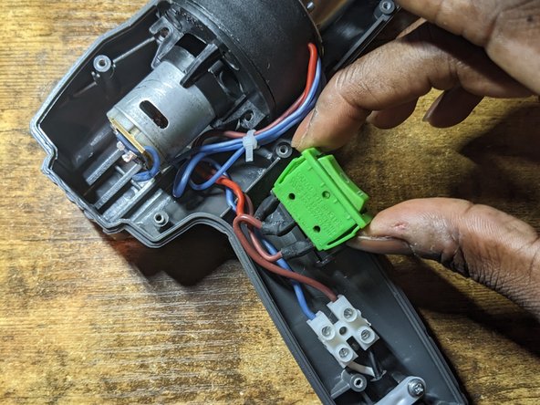

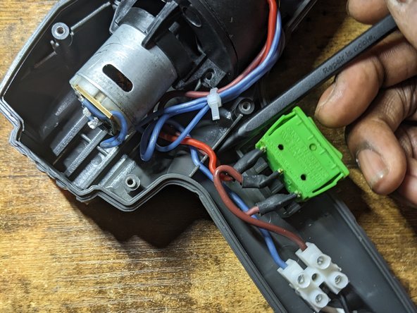

    • Using a phillips screwdriver remove the two 12.5 mm screws that are holding the fan housing to the bottom case.
    • Lift switch out of the bottom case.
    • Lift wires out of their retaining slots.
  4. Genesis Heat Gun Rectifier Diode Replacement, Remove fan motor unit 2: crwdns2935265:04crwdnd2935265:01crwdnd2935265:03crwdne2935265:0 Genesis Heat Gun Rectifier Diode Replacement, Remove fan motor unit 2: crwdns2935265:04crwdnd2935265:02crwdnd2935265:03crwdne2935265:0 Genesis Heat Gun Rectifier Diode Replacement, Remove fan motor unit 2: crwdns2935265:04crwdnd2935265:03crwdnd2935265:03crwdne2935265:0

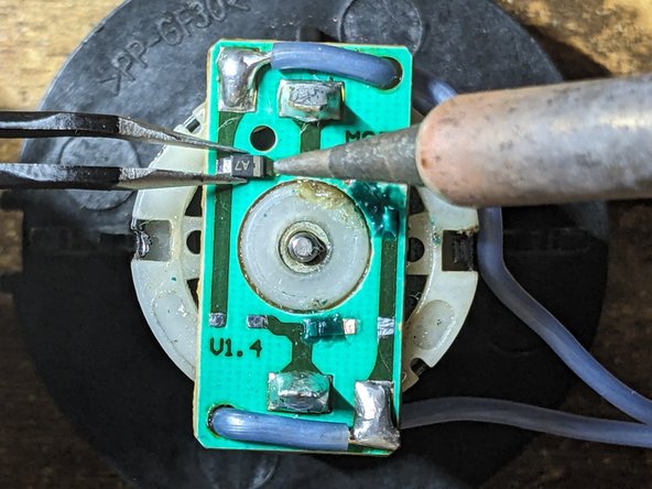

    • Method 2 (2 soldering irons) [Photo 2]
    • Heat up both soldering irons.

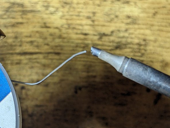

    • Add fresh solder to both ends of the diode. (Photo 1)
    • Hold iron onto the end of the diode and feed solder onto the board right at the tip of the soldering iron.
    • Hold soldering irons on both ends of the diode and lift the diode off of the circuit board once the solder melts. (Photo 2)

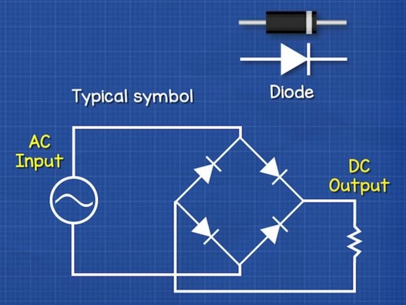

    • Makes sure the diodes are arranged correctly, in order for the AC input to be rectified into a DC output.
    • Take note of the end of the diode with a line through it.
