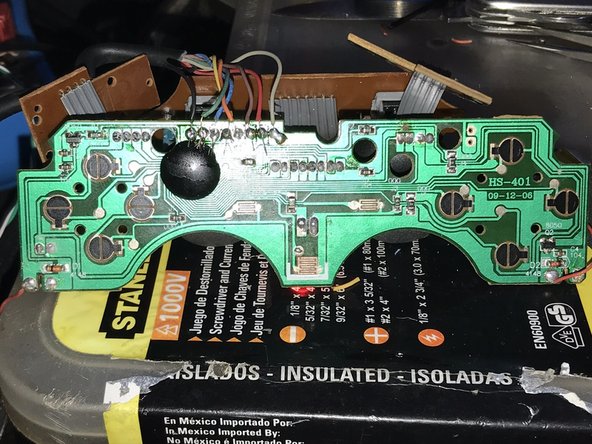

    • First, check that the connection port of your controller (whether wireless or not) has all the pins.
    • If you have a wired controller (a controller with a cable that connects directly to your console) try bending it in different directions. This may reconnect broken connections within the controller cable and could be a temporary fix.
  2. Generic DualShock 2 Cable Pinout: crwdns2935265:02crwdnd2935265:01crwdnd2935265:02crwdne2935265:0 Generic DualShock 2 Cable Pinout: crwdns2935265:02crwdnd2935265:02crwdnd2935265:02crwdne2935265:0
    • Flip Over Controller and remove all 6 screws from the bottom of the controller.
  3. Generic DualShock 2 Cable Pinout: crwdns2935265:03crwdnd2935265:01crwdnd2935265:02crwdne2935265:0 Generic DualShock 2 Cable Pinout: crwdns2935265:03crwdnd2935265:02crwdnd2935265:02crwdne2935265:0
    • Once the screws are removed, carefully pry the controller open with your hands.
    • Remove the screw holding the circuit board in place.
  4. Generic DualShock 2 Cable Pinout: crwdns2935265:04crwdnd2935265:01crwdnd2935265:01crwdne2935265:0
    • Carefully remove the circuit board from the front cover of the controller.
  5. Generic DualShock 2 Cable Pinout: crwdns2935265:05crwdnd2935265:01crwdnd2935265:01crwdne2935265:0
    • Analyze the rubber pads for any debris that may be getting in the way of the black pads. These make an electrical connection on the pad and may not be contacting properly.
  6. Generic DualShock 2 Cable Pinout: crwdns2935265:06crwdnd2935265:01crwdnd2935265:01crwdne2935265:0
    • Examine the flexible trigger board itself for any dirt or debris that could get in the rubber button pad's way.
  7. Generic DualShock 2 Cable Pinout: crwdns2935265:07crwdnd2935265:01crwdnd2935265:01crwdne2935265:0
    • Check the connection of the flexible trigger board to the main circuit board of your controller.
  8. Generic DualShock 2 Cable Pinout: crwdns2935265:08crwdnd2935265:01crwdnd2935265:01crwdne2935265:0
    • If the previous steps are all covered and you are still facing difficulties in getting your buttons to work, consider replacing the main circuit board or flexible trigger board.
  9. Generic DualShock 2 Cable Pinout: crwdns2935265:09crwdnd2935265:01crwdnd2935265:01crwdne2935265:0
    • Reverse the disassembly steps until the controller is back to its original state. Plug the controller into the console and test whether the fix worked.
  10. Generic DualShock 2 Cable Pinout, Cable Color And Order: crwdns2935265:010crwdnd2935265:01crwdnd2935265:02crwdne2935265:0 Generic DualShock 2 Cable Pinout, Cable Color And Order: crwdns2935265:010crwdnd2935265:02crwdnd2935265:02crwdne2935265:0
    • Here it is how it should be connected.
