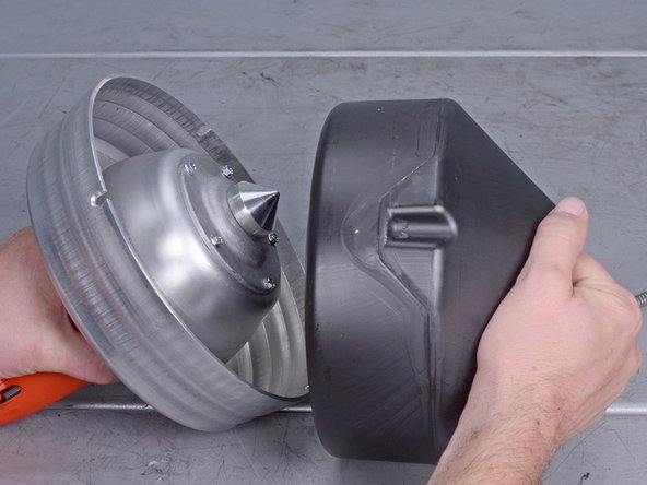

  3. General Wire Drain Cleaner RSVD 2014 Cable Replacement, Remove the front assembly: crwdns2935265:03crwdnd2935265:01crwdnd2935265:03crwdne2935265:0 General Wire Drain Cleaner RSVD 2014 Cable Replacement, Remove the front assembly: crwdns2935265:03crwdnd2935265:02crwdnd2935265:03crwdne2935265:0 General Wire Drain Cleaner RSVD 2014 Cable Replacement, Remove the front assembly: crwdns2935265:03crwdnd2935265:03crwdnd2935265:03crwdne2935265:0
    • Pull the front assembly off of the drain cleaner and slide it over the cable to remove it.
    • During reassembly, make sure the three screws on the front assembly line up with the slots on both the metal cable container back and the plastic cable container.
  4. General Wire Drain Cleaner RSVD 2014 Cable Replacement, Remove the cable container: crwdns2935265:04crwdnd2935265:01crwdnd2935265:02crwdne2935265:0 General Wire Drain Cleaner RSVD 2014 Cable Replacement, Remove the cable container: crwdns2935265:04crwdnd2935265:02crwdnd2935265:02crwdne2935265:0
    • Slide the plastic cable container out of the metal container back.

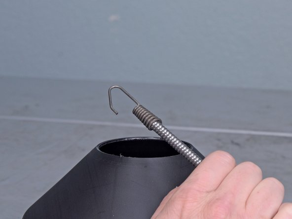

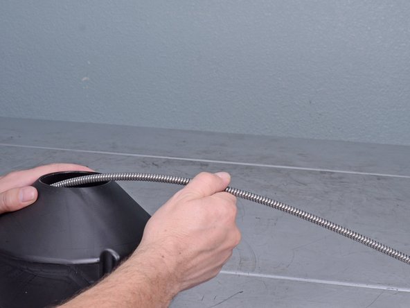

  5. General Wire Drain Cleaner RSVD 2014 Cable Replacement, Remove the cable: crwdns2935265:05crwdnd2935265:01crwdnd2935265:03crwdne2935265:0 General Wire Drain Cleaner RSVD 2014 Cable Replacement, Remove the cable: crwdns2935265:05crwdnd2935265:02crwdnd2935265:03crwdne2935265:0 General Wire Drain Cleaner RSVD 2014 Cable Replacement, Remove the cable: crwdns2935265:05crwdnd2935265:03crwdnd2935265:03crwdne2935265:0
    • Pull the cable out of the plastic cable container.
    • During reassembly, make sure to insert the end of the cable with the hook (as shown in the third photo) first, then coil the rest of the cable into the container in a counter-clockwise fashion.
