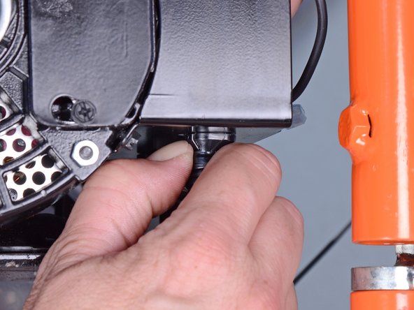

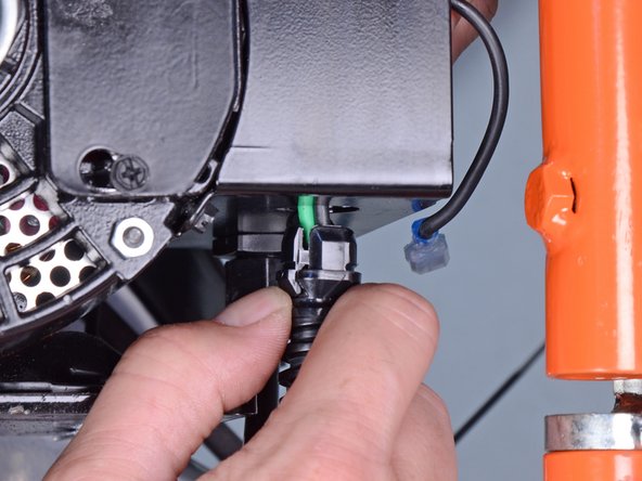

  9. General Pipe Cleaners Drain Cleaner PMEBO 2016 Power Cable Replacement, Power Cable: crwdns2935265:09crwdnd2935265:01crwdnd2935265:03crwdne2935265:0 General Pipe Cleaners Drain Cleaner PMEBO 2016 Power Cable Replacement, Power Cable: crwdns2935265:09crwdnd2935265:02crwdnd2935265:03crwdne2935265:0 General Pipe Cleaners Drain Cleaner PMEBO 2016 Power Cable Replacement, Power Cable: crwdns2935265:09crwdnd2935265:03crwdnd2935265:03crwdne2935265:0
    • Push in on the small tab on the side of the plastic power cable clip.
    • While holding the tab down, pull straight down on the power cable.
    • Do not remove the cable yet, it is still connected to the drain cleaner. Slide it down just enough to move the clip out of the control box.

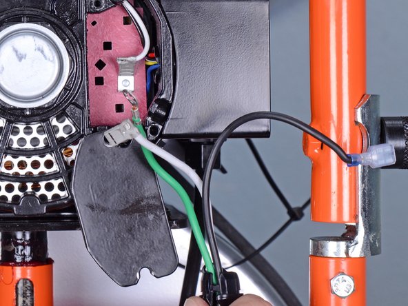

  11. General Pipe Cleaners Drain Cleaner PMEBO 2016 Power Cable Replacement: crwdns2935265:011crwdnd2935265:01crwdnd2935265:01crwdne2935265:0
    • Use a flathead screwdriver to remove the green screw securing the green power cable wire.
  12. General Pipe Cleaners Drain Cleaner PMEBO 2016 Power Cable Replacement: crwdns2935265:012crwdnd2935265:01crwdnd2935265:01crwdne2935265:0
    • Use pliers to pull the white power cable straight off of its spade connector.
  13. General Pipe Cleaners Drain Cleaner PMEBO 2016 Power Cable Replacement: crwdns2935265:013crwdnd2935265:01crwdnd2935265:02crwdne2935265:0 General Pipe Cleaners Drain Cleaner PMEBO 2016 Power Cable Replacement: crwdns2935265:013crwdnd2935265:02crwdnd2935265:02crwdne2935265:0
    • Feed the green power cable wire through the control box first, then carefully pull down on the entire power cable and remove it.
    • Make sure you don't snag the power cable on any wires or on the control box during removal.
    • During reassembly, feed the white wire through the control box and into the power box first, then the green wire.
