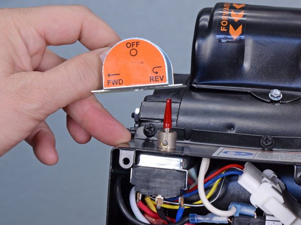

    • Before you begin, make sure the drain cleaner is disconnected from power.
    • Use a Phillips #2 driver to remove the two screws securing the control box cover.

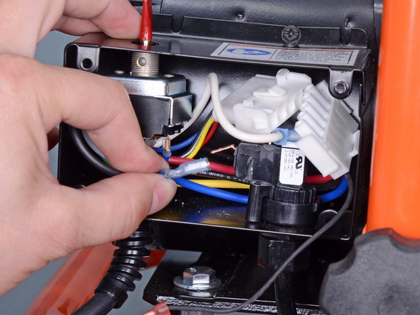

  2. General Pipe Cleaners Drain Cleaner EJB 2014 Reverse Switch Replacement: crwdns2935265:02crwdnd2935265:01crwdnd2935265:01crwdne2935265:0
    • Remove the control box cover.

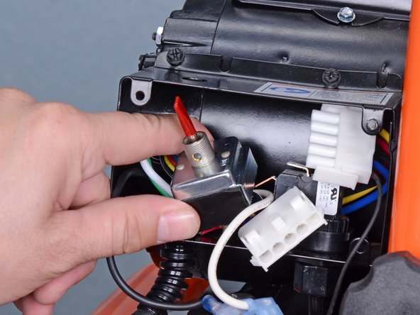

  3. General Pipe Cleaners Drain Cleaner EJB 2014 Reverse Switch Replacement: crwdns2935265:03crwdnd2935265:01crwdnd2935265:01crwdne2935265:0
    • Use a 9/16 inch deep socket and ratchet to remove the nut securing the reverse switch.

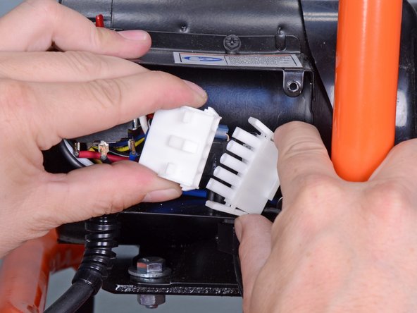

  4. General Pipe Cleaners Drain Cleaner EJB 2014 Reverse Switch Replacement: crwdns2935265:04crwdnd2935265:01crwdnd2935265:02crwdne2935265:0 General Pipe Cleaners Drain Cleaner EJB 2014 Reverse Switch Replacement: crwdns2935265:04crwdnd2935265:02crwdnd2935265:02crwdne2935265:0
    • Remove the reverse switch guard.

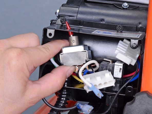

  5. General Pipe Cleaners Drain Cleaner EJB 2014 Reverse Switch Replacement: crwdns2935265:05crwdnd2935265:01crwdnd2935265:02crwdne2935265:0 General Pipe Cleaners Drain Cleaner EJB 2014 Reverse Switch Replacement: crwdns2935265:05crwdnd2935265:02crwdnd2935265:02crwdne2935265:0
    • Squeeze the tabs on either side of the reverse switch connector.
    • Pull the two halves of the connector apart to disconnect it.
    • Take note of where everything is connected in the control box before disconnecting anything else.

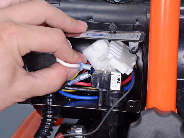

  6. General Pipe Cleaners Drain Cleaner EJB 2014 Reverse Switch Replacement: crwdns2935265:06crwdnd2935265:01crwdnd2935265:02crwdne2935265:0 General Pipe Cleaners Drain Cleaner EJB 2014 Reverse Switch Replacement: crwdns2935265:06crwdnd2935265:02crwdnd2935265:02crwdne2935265:0
    • Pull the white cable straight off of its spade connector on the power switch diaphragm.
  7. General Pipe Cleaners Drain Cleaner EJB 2014 Reverse Switch Replacement: crwdns2935265:07crwdnd2935265:01crwdnd2935265:02crwdne2935265:0 General Pipe Cleaners Drain Cleaner EJB 2014 Reverse Switch Replacement: crwdns2935265:07crwdnd2935265:02crwdnd2935265:02crwdne2935265:0
    • Pull the black cable straight off of its spade connector on the power switch diaphragm.
  8. General Pipe Cleaners Drain Cleaner EJB 2014 Reverse Switch Replacement: crwdns2935265:08crwdnd2935265:01crwdnd2935265:03crwdne2935265:0 General Pipe Cleaners Drain Cleaner EJB 2014 Reverse Switch Replacement: crwdns2935265:08crwdnd2935265:02crwdnd2935265:03crwdne2935265:0 General Pipe Cleaners Drain Cleaner EJB 2014 Reverse Switch Replacement: crwdns2935265:08crwdnd2935265:03crwdnd2935265:03crwdne2935265:0
    • Slide the switch assembly down out of its hole in the control box and pull it out of the control box.
    • Be careful not to snag the switch on any cables during removal.
