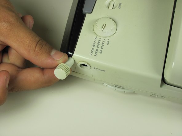

  4. General Electric Telephone 2-9710A Base Speaker Replacement, Remove Volume Dial: crwdns2935265:04crwdnd2935265:01crwdnd2935265:02crwdne2935265:0 General Electric Telephone 2-9710A Base Speaker Replacement, Remove Volume Dial: crwdns2935265:04crwdnd2935265:02crwdnd2935265:02crwdne2935265:0
    • Ensure the phone is unplugged from the phone jack and the electrical source.
    • Locate the volume dial on the right side of the telephone.
    • Remove the volume dial by gently grasping it and pulling it away from the base.

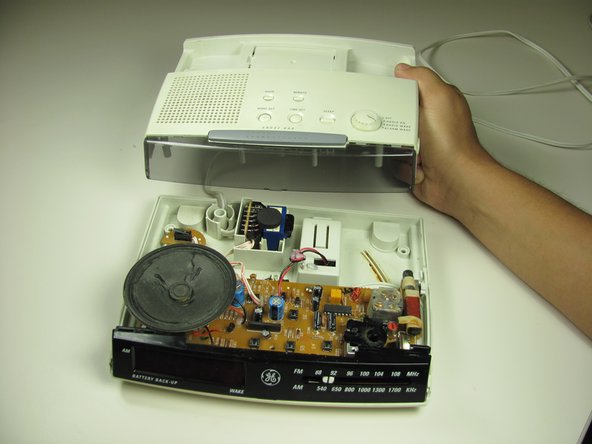

  6. General Electric Telephone 2-9710A Base Speaker Replacement, Pry the Back Off: crwdns2935265:06crwdnd2935265:01crwdnd2935265:02crwdne2935265:0 General Electric Telephone 2-9710A Base Speaker Replacement, Pry the Back Off: crwdns2935265:06crwdnd2935265:02crwdnd2935265:02crwdne2935265:0
    • Pry off the base shell using a plastic opener tool.
    • Set the shell aside.
    • You now have access to the internal components of the General Electric Telephone 2-9710A.

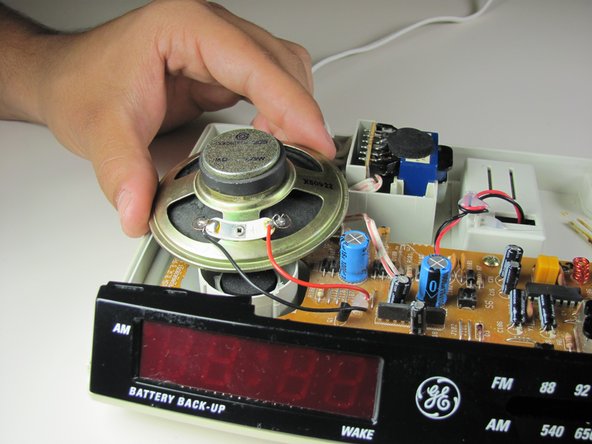

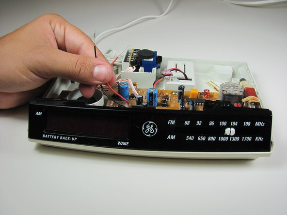

  7. General Electric Telephone 2-9710A Base Speaker Replacement, Base Speaker: crwdns2935265:07crwdnd2935265:01crwdnd2935265:03crwdne2935265:0 General Electric Telephone 2-9710A Base Speaker Replacement, Base Speaker: crwdns2935265:07crwdnd2935265:02crwdnd2935265:03crwdne2935265:0 General Electric Telephone 2-9710A Base Speaker Replacement, Base Speaker: crwdns2935265:07crwdnd2935265:03crwdnd2935265:03crwdne2935265:0
    • Slightly pull out speaker.
    • Cut wire as close as speaker as possible with wire cutters.
    • Remove speaker.

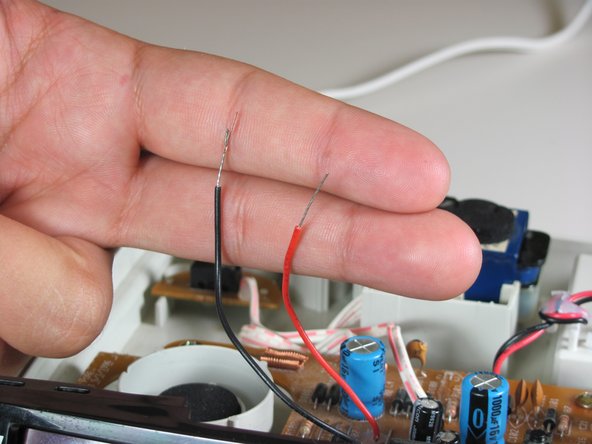

  8. General Electric Telephone 2-9710A Base Speaker Replacement: crwdns2935265:08crwdnd2935265:01crwdnd2935265:03crwdne2935265:0 General Electric Telephone 2-9710A Base Speaker Replacement: crwdns2935265:08crwdnd2935265:02crwdnd2935265:03crwdne2935265:0 General Electric Telephone 2-9710A Base Speaker Replacement: crwdns2935265:08crwdnd2935265:03crwdnd2935265:03crwdne2935265:0
    • Strip the wire half an inch using wire strippers for a 24 gauge wire.

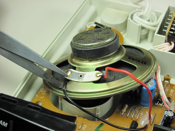

  9. General Electric Telephone 2-9710A Base Speaker Replacement: crwdns2935265:09crwdnd2935265:01crwdnd2935265:01crwdne2935265:0
    • Solder on the new speaker.
    • Please visit How to Solder to learn more about soldering.
