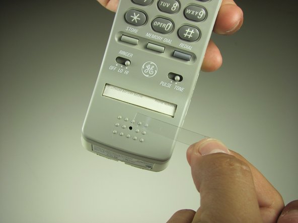

    • Remove the plastic cover with a plastic opening tool by gently sliding the tool underneath the plastic and pry the cover off.

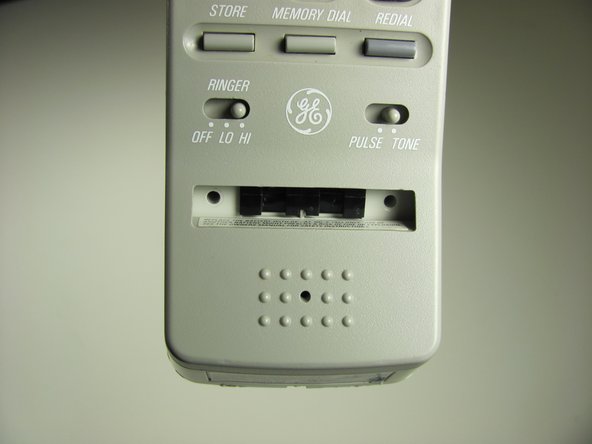

    • Remove the paper with a plastic opening tool by gently sliding the tool underneath and prying the paper away from the phone.

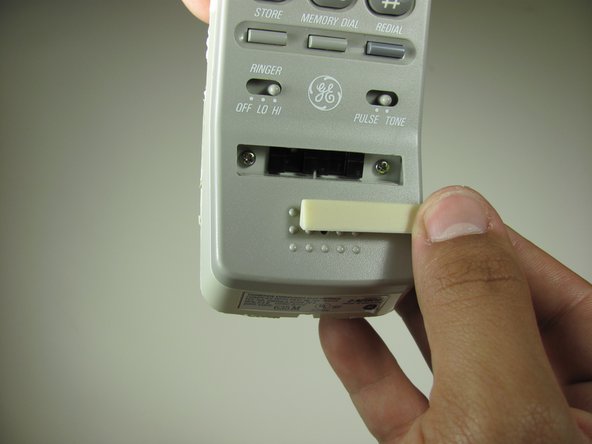

    • Remove the rubber stopper with a plastic opening tool by gently sliding the tool underneath and pry away from the phone.

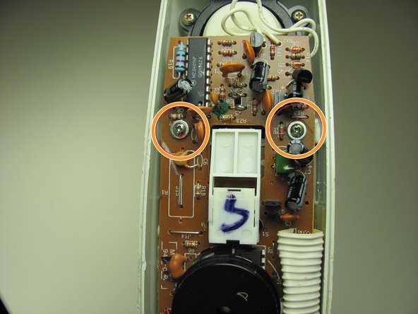

    • Remove 3 screws attaching the motherboard to shell.
    • Remove the 13 mm screw with a Philips #1 screwdriver.
    • Remove the two 13 mm screws with washers with a Philips #1 screwdriver.

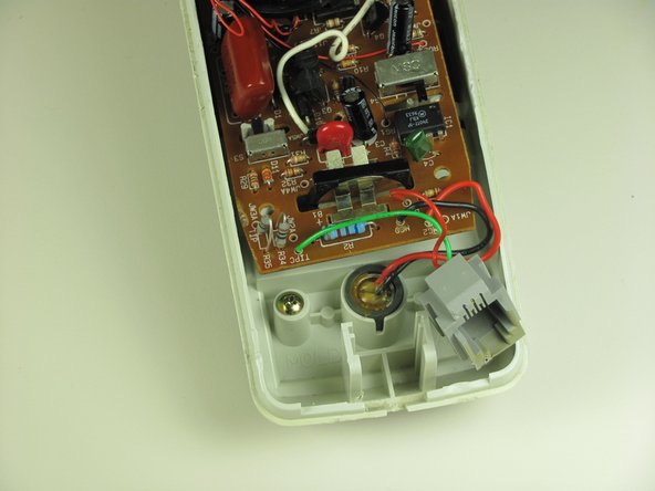

    • Without removing the motherboard completely, pull up slightly and pivot the motherboard out of the shell.
    • Be careful not to pull the connectors out.

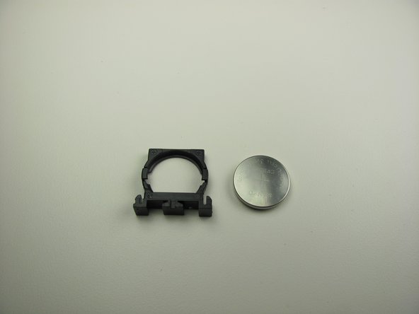

    • Lift tabs on the side of the holder by putting your fingers directly on the tab to pull it apart.
    • While holding the battery, remove it from the holder.
  13. General Electric Telephone 2-9710A 3V Headset Battery Replacement: crwdns2935265:013crwdnd2935265:01crwdnd2935265:01crwdne2935265:0
    • Now insert the new battery.
    • Ensure that the positive side of the battery is facing the tabs.
