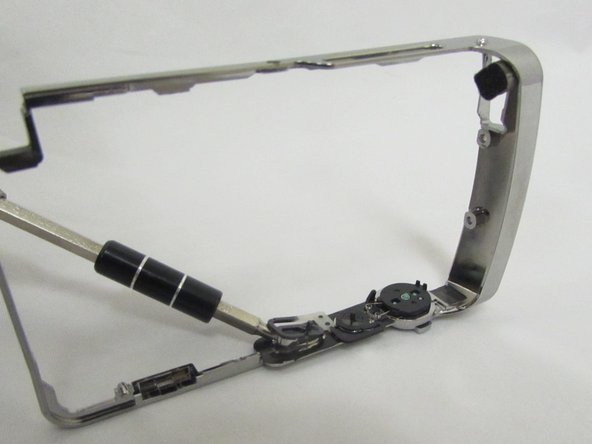

      • Locate the metal frame removed from around the camera in step 3.
      • Lay the frame button side down or flat and gently pry the button out of place with the 3.0 flathead bit or a pair of tweezers.
      • This is very brittle plastic so use extreme caution and minimal force.

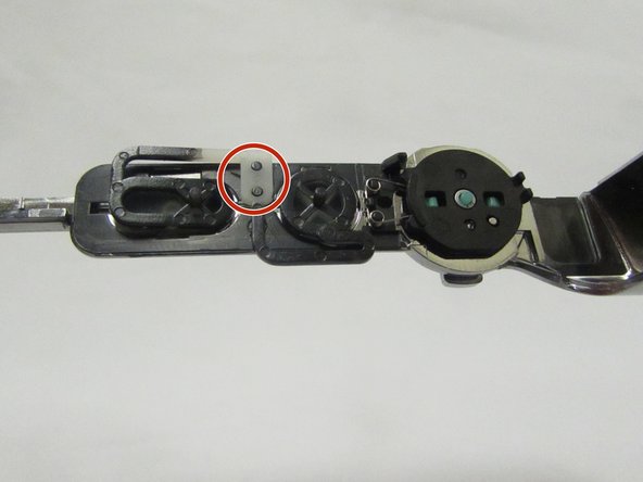

      • The button is secured to the frame by two small black rods pushed into the white colored portion of the button (see picture).
    2. General Electric Create Jason Wu Power Supply Button Replacement: crwdns2935265:06crwdnd2935265:01crwdnd2935265:01crwdne2935265:0
      • The button will pry off easily and shouldn't take much force
