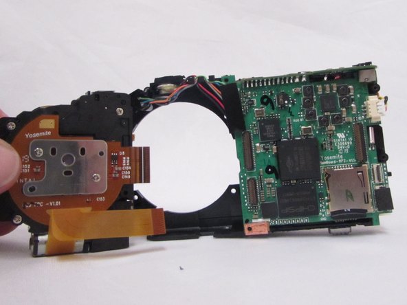

  7. General Electric Create Jason Wu Lens Replacement: crwdns2935265:07crwdnd2935265:01crwdnd2935265:03crwdne2935265:0 General Electric Create Jason Wu Lens Replacement: crwdns2935265:07crwdnd2935265:02crwdnd2935265:03crwdne2935265:0 General Electric Create Jason Wu Lens Replacement: crwdns2935265:07crwdnd2935265:03crwdnd2935265:03crwdne2935265:0
    • Locate the six 1.5mm Phillips screws that are holding on the interior camera frame.
    • Using the Phillips precision screwdriver and the PH000 Phillips bit, remove the 6 screws.
    • With the screws removed, the interior frame will no longer be fastened to the camera body and can be lifted up and away.

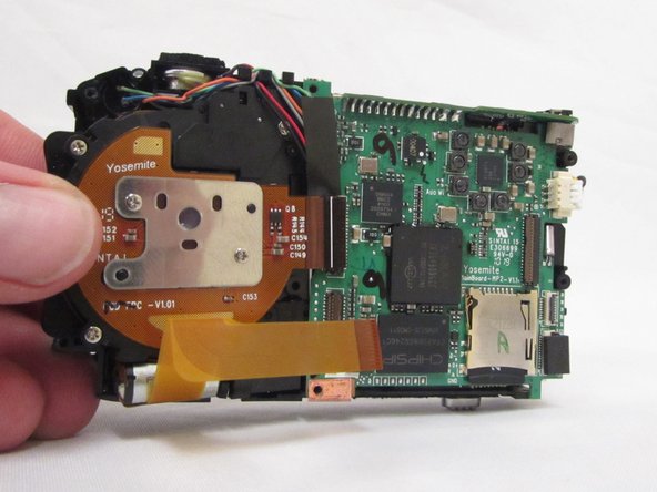

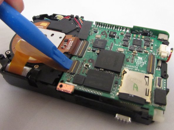

  8. General Electric Create Jason Wu Lens Replacement, Lens: crwdns2935265:08crwdnd2935265:01crwdnd2935265:02crwdne2935265:0 General Electric Create Jason Wu Lens Replacement, Lens: crwdns2935265:08crwdnd2935265:02crwdnd2935265:02crwdne2935265:0
    • Locate the 2 connection ribbons attaching the lens to the circuit board.
    • Using a plastic opening tool or finger nail, gently lift the ZIF connector flaps up.
    • The connectors are hinged and will fold up and away from the ribbon, do not disconnect completely.
  9. General Electric Create Jason Wu Lens Replacement: crwdns2935265:09crwdnd2935265:01crwdnd2935265:02crwdne2935265:0 General Electric Create Jason Wu Lens Replacement: crwdns2935265:09crwdnd2935265:02crwdnd2935265:02crwdne2935265:0
    • With the hinged connectors folded up and out of the way, carefully pull the ribbons out of their connectors.
    • These are the only 2 connectors holding the lens assembly in place. If disconnected the lens assembly will be completely detached from the camera.

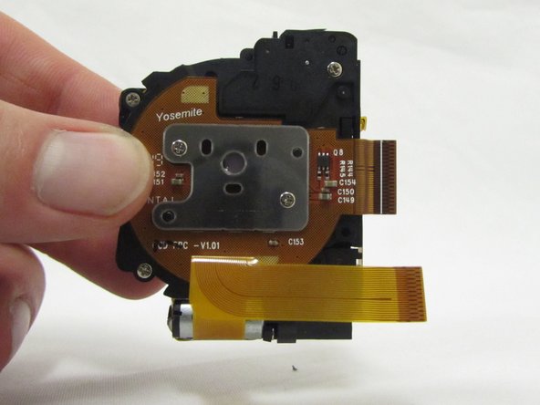

  10. General Electric Create Jason Wu Lens Replacement: crwdns2935265:010crwdnd2935265:01crwdnd2935265:03crwdne2935265:0 General Electric Create Jason Wu Lens Replacement: crwdns2935265:010crwdnd2935265:02crwdnd2935265:03crwdne2935265:0 General Electric Create Jason Wu Lens Replacement: crwdns2935265:010crwdnd2935265:03crwdnd2935265:03crwdne2935265:0
    • Firmly grasp the camera body in your right hand and grab the lens assembly with your other hand.
    • Gently pull the lens assembly directly up and out of the camera body.
    • There are no further screws or connections hold the lens assembly in place. If it does not remove easily check your previous steps.
