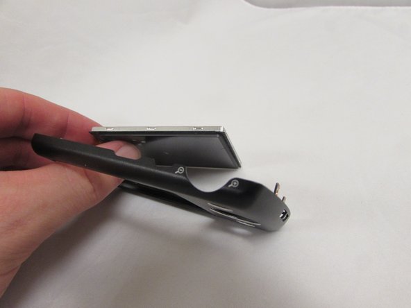

  5. General Electric Create Jason Wu LCD Screen Replacement, LCD Screen: crwdns2935265:05crwdnd2935265:01crwdnd2935265:02crwdne2935265:0 General Electric Create Jason Wu LCD Screen Replacement, LCD Screen: crwdns2935265:05crwdnd2935265:02crwdnd2935265:02crwdne2935265:0
    • With the back casing that you just separated from the camera, use your finger to push the LCD screen from the frame.
    • The LCD screen is secured to the frame with a thin layer of adhesive, not much force is required to removed the screen from the back casing.
    • Before replacing the back casing with the new LCD screen, please be sure it is secured into the casing with new adhesive.
