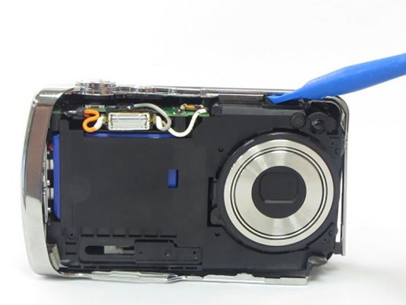

    • After the screws are removed, pull the front casing up and away from the camera.
    • If the casing is difficult to remove, use a plastic opening tool to gently pry up on the front as shown.

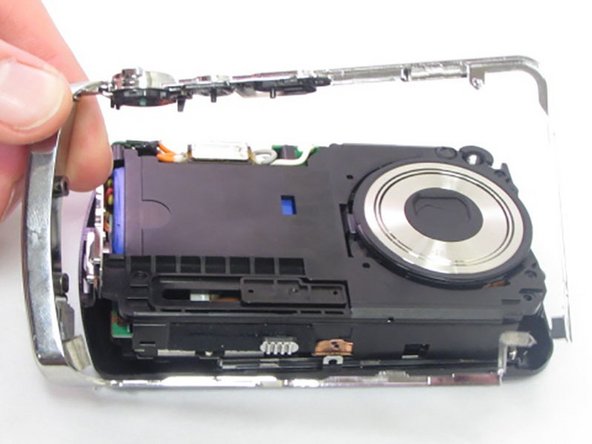

    • Using your hands or an opening tool, pry off the silver frame, taking special care at the top of the camera where the buttons are as it is a little harder to pry off.
    • If the back casing is loose from the camera body, it may be easier to perform step 4 first, then accomplish this step. Proceed as your unit allows.

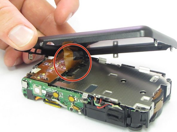

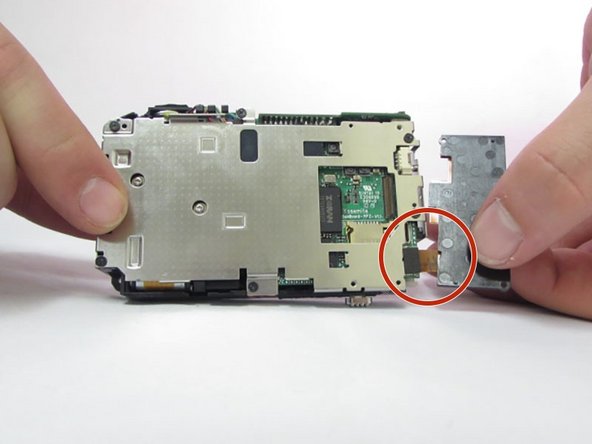

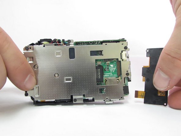

    • The last part of the casing to disconnect is the back that houses the LCD screen.
    • The screen is attached by a connection ribbon. Gently pull the casing and screen away from the camera body to disconnect the casing.
    • The LCD screen is held onto the back casing by a small amount of adhesive. This may come loose during this process. Do not worry if they become separated.
    • This plug and the connection ribbon are fragile, try not to tear the connection ribbon when disconnecting.

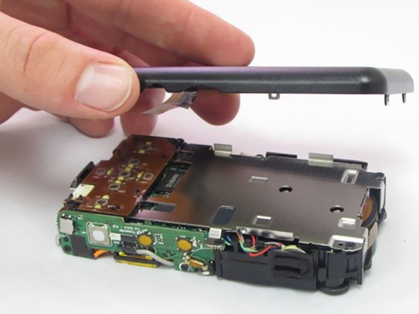

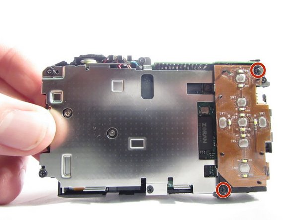

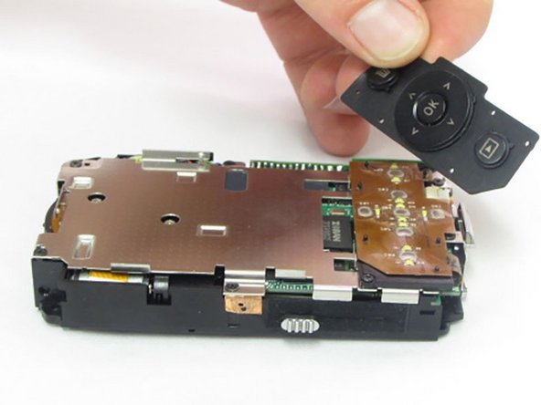

    • After the casing is removed, use your fingers to carefully lift up on the rubber pad, if it didn't already fall out during step 4.
    • The pad isn't secured to the camera so it will lift up and pull away easily.
    • After the pad is removed, the 2 Phillips head screws holding the control board will be exposed.
  6. General Electric Create Jason Wu Internal Memory Card Replacement: crwdns2935265:06crwdnd2935265:01crwdnd2935265:03crwdne2935265:0 General Electric Create Jason Wu Internal Memory Card Replacement: crwdns2935265:06crwdnd2935265:02crwdnd2935265:03crwdne2935265:0 General Electric Create Jason Wu Internal Memory Card Replacement: crwdns2935265:06crwdnd2935265:03crwdnd2935265:03crwdne2935265:0
    • Using the Phillips precision screwdriver with the PH000 Phillips bit, remove the two 1.5mm screws.
    • Although the 2 screws are removed, the button board is still attached with a connection ribbon.
    • With a firm grip towards the bottom of the control board, gently pull away from the camera, removing the ribbon from the connector.

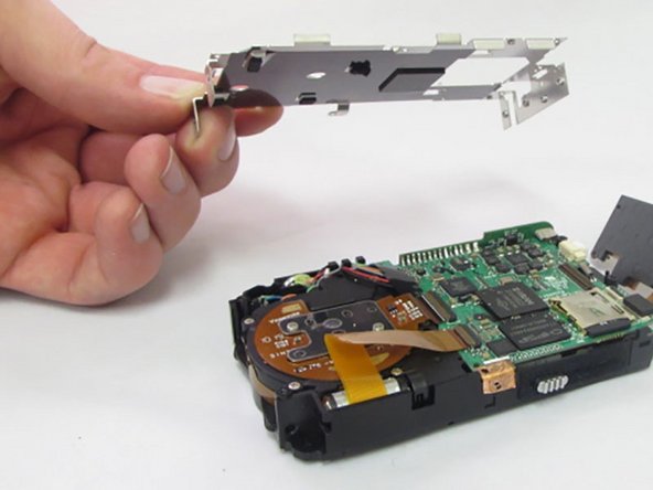

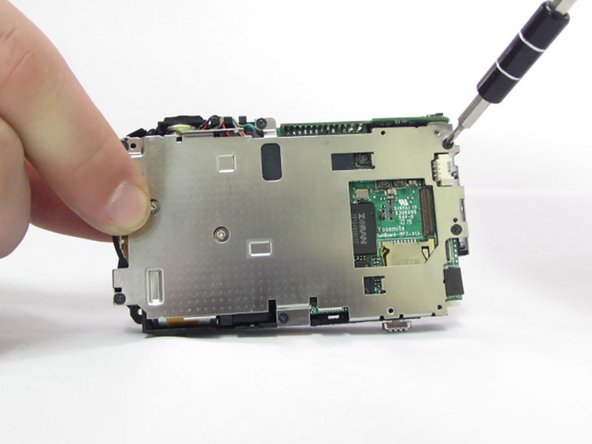

    • Locate the six 1.5mm Phillips screws that are holding on the interior camera frame.
    • Using the Phillips precision screwdriver and the PH000 Phillips bit, remove the 6 screws.
    • With the screws removed, the interior frame will no longer be fastened to the camera body and can be lifted up and away.

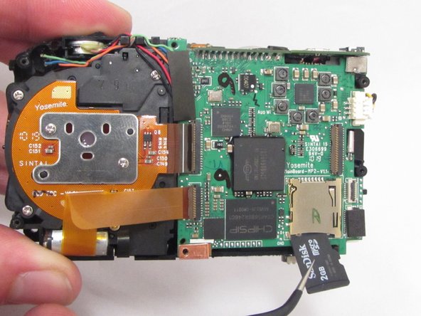

  8. General Electric Create Jason Wu Internal Memory Card Replacement, Internal Memory Card: crwdns2935265:08crwdnd2935265:01crwdnd2935265:03crwdne2935265:0 General Electric Create Jason Wu Internal Memory Card Replacement, Internal Memory Card: crwdns2935265:08crwdnd2935265:02crwdnd2935265:03crwdne2935265:0 General Electric Create Jason Wu Internal Memory Card Replacement, Internal Memory Card: crwdns2935265:08crwdnd2935265:03crwdnd2935265:03crwdne2935265:0

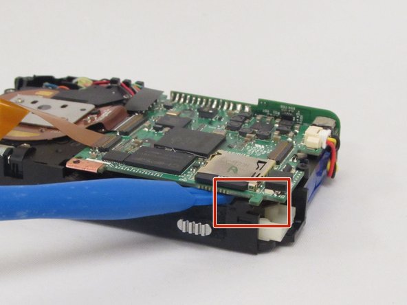

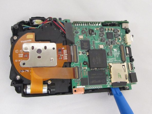

    • Locate the memory card slot in the bottom right corner of the camera.
    • Using a plastic opening tool, gently pry up on the edges of the bottom right corner of the control board.
    • Gently raise the lower right corner of the circuit board by prying upwards with an opening tool.
  9. General Electric Create Jason Wu Internal Memory Card Replacement: crwdns2935265:09crwdnd2935265:01crwdnd2935265:02crwdne2935265:0 General Electric Create Jason Wu Internal Memory Card Replacement: crwdns2935265:09crwdnd2935265:02crwdnd2935265:02crwdne2935265:0
    • Using a pair of precision tweezers, slide one end under the memory card.
    • Firmly grip the memory card with the tweezers and pull directly outwards.
    • The tweezers may not be necessary in this step and the memory card may be removed by hand using a finger nail.
