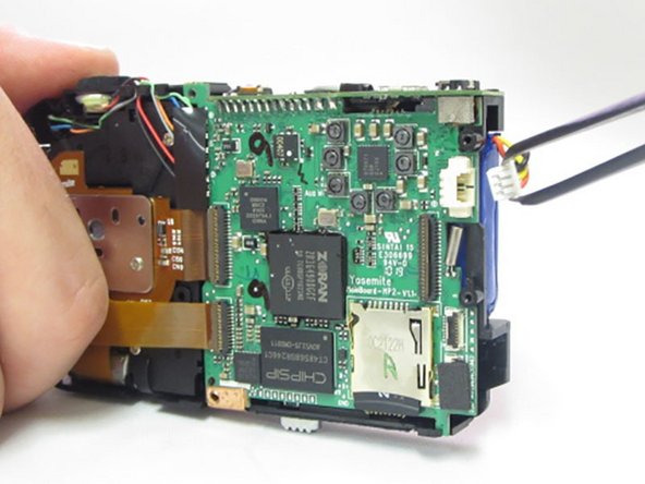

    1. General Electric Create Jason Wu Battery Replacement, Battery: crwdns2935265:08crwdnd2935265:01crwdnd2935265:02crwdne2935265:0 General Electric Create Jason Wu Battery Replacement, Battery: crwdns2935265:08crwdnd2935265:02crwdnd2935265:02crwdne2935265:0
      • Using the Curved Precision Tweezers, detach battery plug from socket.
      • Some may find the tweezers unnecessary for this step and instead may use their fingers to gently detach the plug.

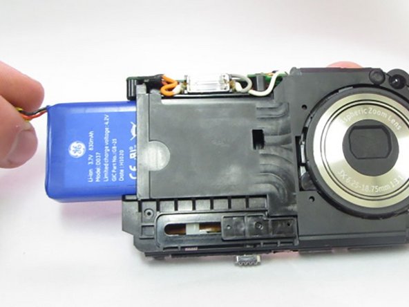

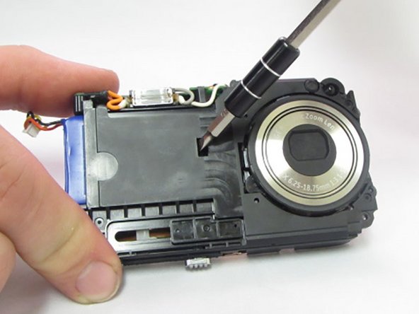

      • Swap the 3.0 Flathead bit into the precision screw driver.
      • On the front of the camera locate the small rectangular slot where the battery is exposed.
      • Use the flathead bit to gently pry on the battery to start pushing it out of the camera, allowing it to become loose.
      • Do not pull the battery out too hard or the wires will break.
