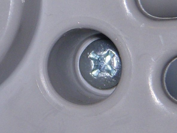

  6. General Electric Bagel Switch 4-Slice Power Supply Replacement: crwdns2935265:07crwdnd2935265:01crwdnd2935265:01crwdne2935265:0
    • Using wire cutters, cut the power supply cable close to the base of the toaster, leave about 2 inches of wire.
  7. General Electric Bagel Switch 4-Slice Power Supply Replacement: crwdns2935265:08crwdnd2935265:01crwdnd2935265:01crwdne2935265:0
    • Pull the power supply cord through the bottom plate of the toaster.
    • Insert the end of the new power supply cable through the hole in the bottom plate.
  8. General Electric Bagel Switch 4-Slice Power Supply Replacement: crwdns2935265:010crwdnd2935265:01crwdnd2935265:01crwdne2935265:0
    • Strip about an inch of the wire insulation (casing) off the ends of both the new power supply cable, and the old power supply cable that is still attached to the toaster.
    • Splice the stripped ends of wire together using a wire cap.
