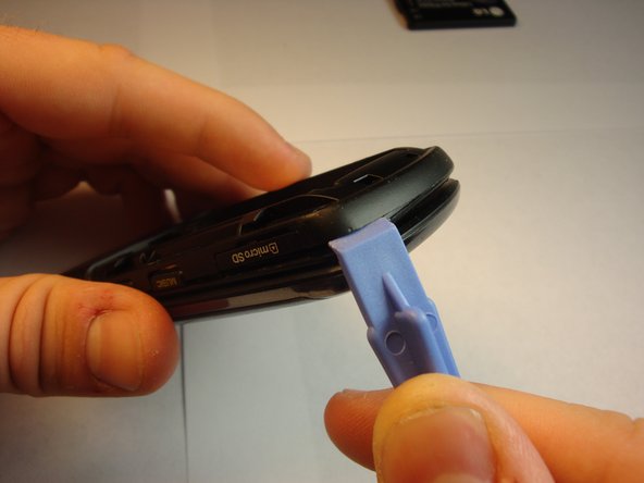

  5. General Disassembly LG VX8560: crwdns2935265:05crwdnd2935265:01crwdnd2935265:02crwdne2935265:0 General Disassembly LG VX8560: crwdns2935265:05crwdnd2935265:02crwdnd2935265:02crwdne2935265:0
    • Using your plastic pry tool, insert the tool between the phone’s keypad cover and back cover and gently pry apart.
  6. General Disassembly LG VX8560: crwdns2935265:06crwdnd2935265:01crwdnd2935265:01crwdne2935265:0
    • Once the covers have been separated the motherboard will be visible. Do not separate the two covers completely. The covers will be held together by a screw on the axis of the phone.
