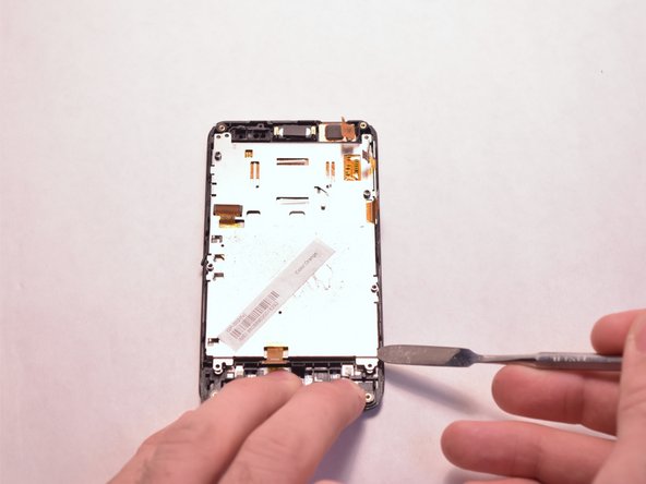

  14. GeeksPhone Keon Screen Replacement, Screen: crwdns2935265:014crwdnd2935265:01crwdnd2935265:02crwdne2935265:0 GeeksPhone Keon Screen Replacement, Screen: crwdns2935265:014crwdnd2935265:02crwdnd2935265:02crwdne2935265:0
    • Use the metal spudger to gently lift up the back of the screen.

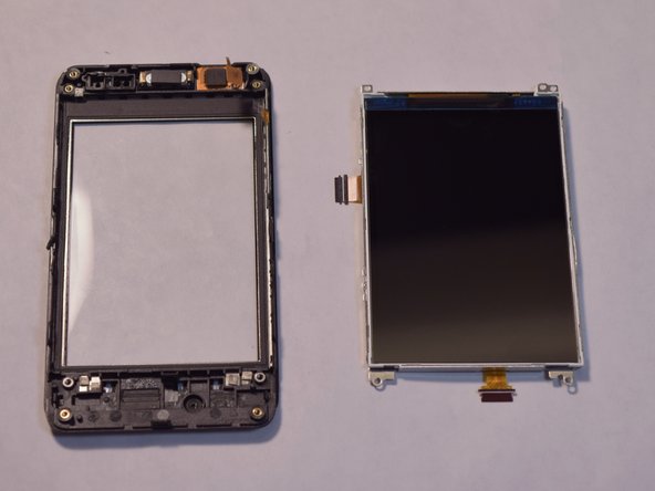

  15. GeeksPhone Keon Screen Replacement: crwdns2935265:015crwdnd2935265:01crwdnd2935265:02crwdne2935265:0 GeeksPhone Keon Screen Replacement: crwdns2935265:015crwdnd2935265:02crwdnd2935265:02crwdne2935265:0
    • Continue to lift up the screen until it is loose from the device.
