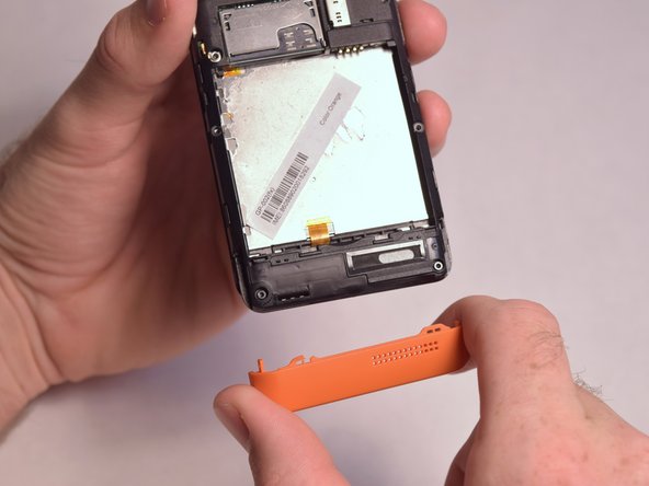

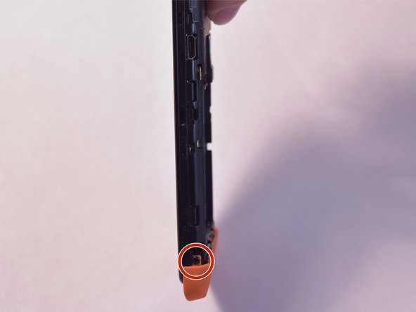

    • Remove the two 5mm T4 screws on the sides of the small orange plate.
  5. GeeksPhone Keon Motherboard Replacement: crwdns2935265:05crwdnd2935265:01crwdnd2935265:02crwdne2935265:0 GeeksPhone Keon Motherboard Replacement: crwdns2935265:05crwdnd2935265:02crwdnd2935265:02crwdne2935265:0
    • Gently remove the small orange plate by pulling it down.

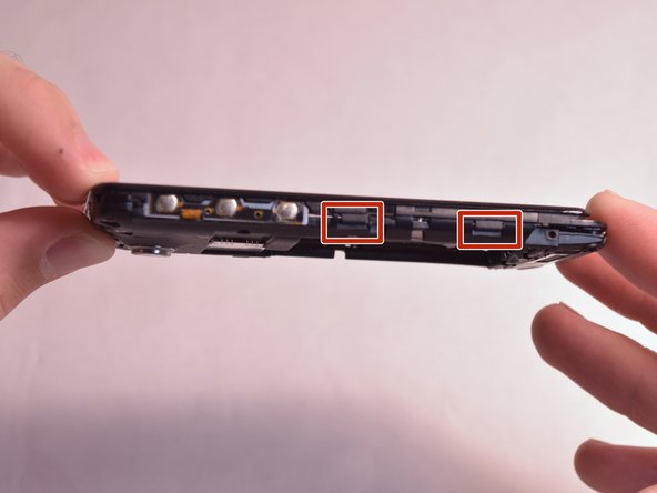

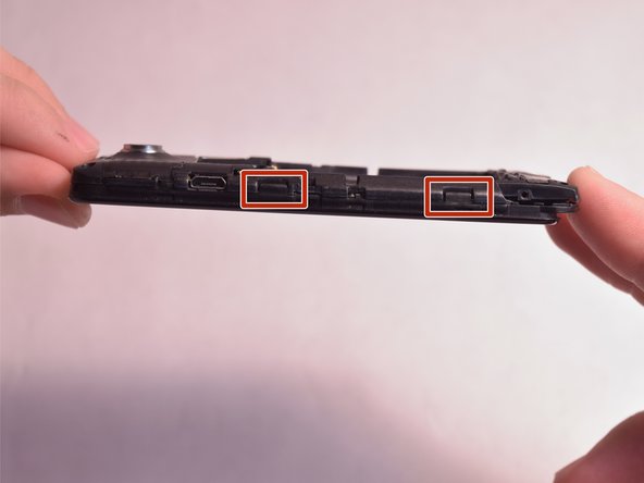

  7. GeeksPhone Keon Motherboard Replacement: crwdns2935265:07crwdnd2935265:01crwdnd2935265:03crwdne2935265:0 GeeksPhone Keon Motherboard Replacement: crwdns2935265:07crwdnd2935265:02crwdnd2935265:03crwdne2935265:0 GeeksPhone Keon Motherboard Replacement: crwdns2935265:07crwdnd2935265:03crwdnd2935265:03crwdne2935265:0
    • Slightly lift up the bottom corner of the backplate.
    • Release the four clips on both sides by pulling them away from the device.

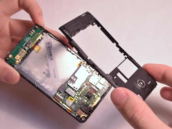

  8. GeeksPhone Keon Motherboard Replacement: crwdns2935265:08crwdnd2935265:01crwdnd2935265:02crwdne2935265:0 GeeksPhone Keon Motherboard Replacement: crwdns2935265:08crwdnd2935265:02crwdnd2935265:02crwdne2935265:0
    • Lift the backplate away from the device.

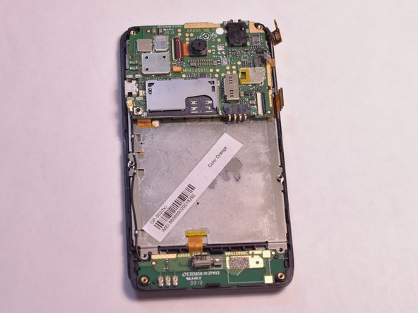

  9. GeeksPhone Keon Motherboard Replacement, Motherboard: crwdns2935265:09crwdnd2935265:01crwdnd2935265:02crwdne2935265:0 GeeksPhone Keon Motherboard Replacement, Motherboard: crwdns2935265:09crwdnd2935265:02crwdnd2935265:02crwdne2935265:0
    • Remove the three connections from the back of the motherboard by using the tip of a spudger or your fingernail to flip up the small retaining flap. Then pull the ribbon cable out.
    • Remove the wire from the bottom left of the motherboard by lifting it away from the device.
    • Remove the 2mm T3 screw in the upper left corner of the motherboard.
