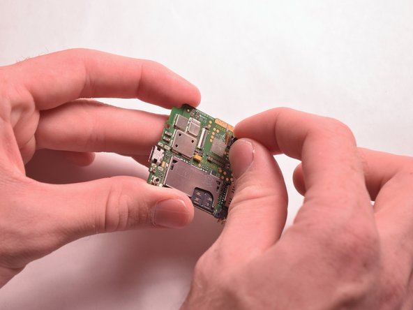

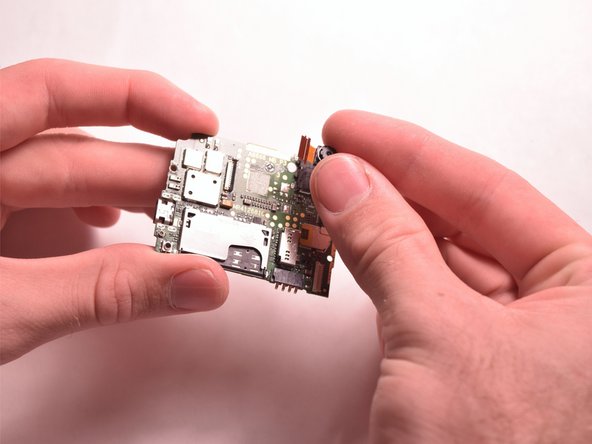

    1. GeeksPhone Keon  Camera Replacement, Camera: crwdns2935265:09crwdnd2935265:01crwdnd2935265:01crwdne2935265:0
      • Lift the retaining flap on camera's ZIF connector.
      • Pull the ribbon cable away with tweezers.
    2. GeeksPhone Keon  Camera Replacement: crwdns2935265:010crwdnd2935265:01crwdnd2935265:03crwdne2935265:0 GeeksPhone Keon  Camera Replacement: crwdns2935265:010crwdnd2935265:02crwdnd2935265:03crwdne2935265:0 GeeksPhone Keon  Camera Replacement: crwdns2935265:010crwdnd2935265:03crwdnd2935265:03crwdne2935265:0
      • Carefully wiggle the camera away from the device.
To reassemble your device, follow these instructions in reverse order; but remember, the new camera must be glued back in place where the old one was removed.
