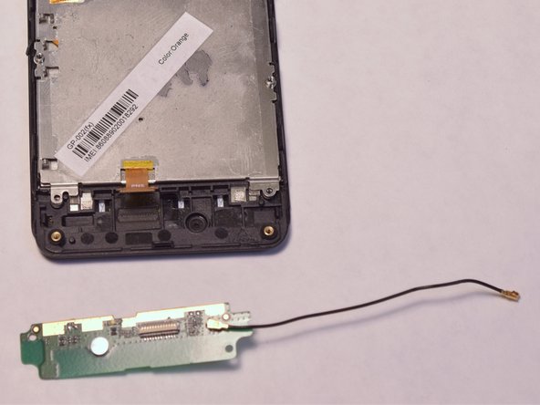

  9. GeeksPhone Keon  Antenna Replacement, Antenna: crwdns2935265:09crwdnd2935265:01crwdnd2935265:01crwdne2935265:0
    • Unfasten the black wire from the metal clamps by hand and lift the black wire away from the device.
    • Unfasten the plastic clamps attached to the antenna.

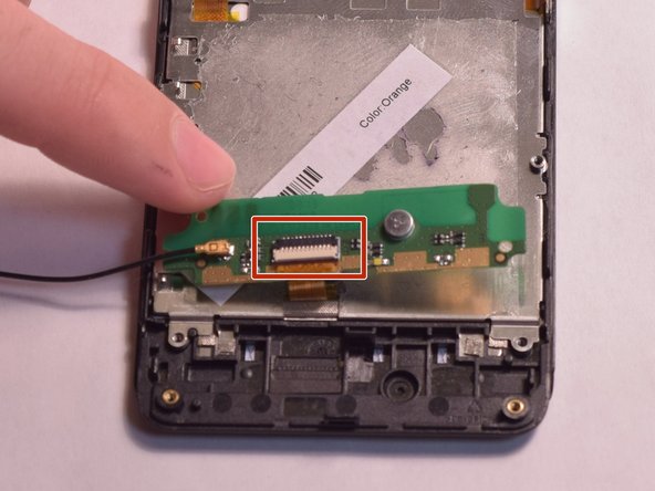

  10. GeeksPhone Keon  Antenna Replacement: crwdns2935265:010crwdnd2935265:01crwdnd2935265:03crwdne2935265:0 GeeksPhone Keon  Antenna Replacement: crwdns2935265:010crwdnd2935265:02crwdnd2935265:03crwdne2935265:0 GeeksPhone Keon  Antenna Replacement: crwdns2935265:010crwdnd2935265:03crwdnd2935265:03crwdne2935265:0
    • Gently lift the antenna and flip it over to reveal a ZIF connector on the back.
    • Flip up the small retaining flap on the ZIF connector and pull the ribbon cable out.
