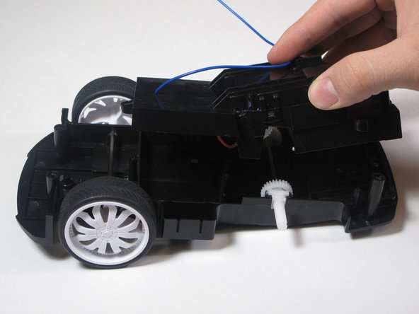

  5. Geardup RC Ford Mustang GT Car Circuit Board Replacement, Motor/Circuit Board Enclosure: crwdns2935265:05crwdnd2935265:01crwdnd2935265:02crwdne2935265:0 Geardup RC Ford Mustang GT Car Circuit Board Replacement, Motor/Circuit Board Enclosure: crwdns2935265:05crwdnd2935265:02crwdnd2935265:02crwdne2935265:0
    • Remove the eight 5mm Phillips #0 screws located on the top of the motor/circuit board enclosure.
    • Vertically lift the motor/circuit board enclosure from the car chassis.

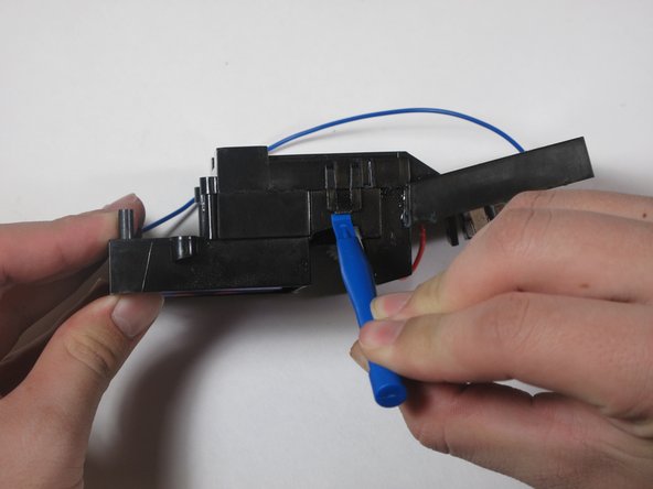

  6. Geardup RC Ford Mustang GT Car Circuit Board Replacement: crwdns2935265:06crwdnd2935265:01crwdnd2935265:02crwdne2935265:0 Geardup RC Ford Mustang GT Car Circuit Board Replacement: crwdns2935265:06crwdnd2935265:02crwdnd2935265:02crwdne2935265:0
    • Using a small plastic opening tool, gently pry the clips to release the tabs on the circuit board casing. The clips can be located above where the rear wheels used to be.
    • Lift the clips just enough to release them from the tabs. If they are pried too far, they may snap off.
    • There is a clear gear grease inside the enclosure.

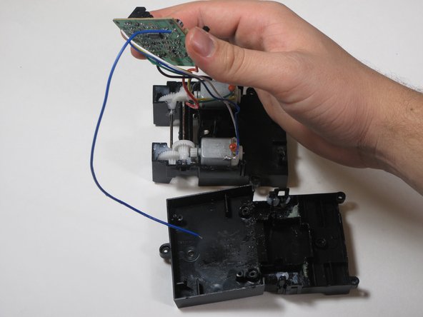

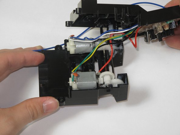

  7. Geardup RC Ford Mustang GT Car Circuit Board Replacement: crwdns2935265:07crwdnd2935265:01crwdnd2935265:02crwdne2935265:0 Geardup RC Ford Mustang GT Car Circuit Board Replacement: crwdns2935265:07crwdnd2935265:02crwdnd2935265:02crwdne2935265:0
    • Lift the circuit board casing from the enclosure to reveal the motors, gears, and circuit board.
    • During re-assembly, make sure the wires are not pinched between plastic dividers in the enclosure as this may damage them.
