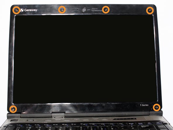

  3. Gateway W350I Display Replacement, Remove Rubber Protectors & Screws: crwdns2935265:03crwdnd2935265:01crwdnd2935265:02crwdne2935265:0 Gateway W350I Display Replacement, Remove Rubber Protectors & Screws: crwdns2935265:03crwdnd2935265:02crwdnd2935265:02crwdne2935265:0
    • Pry the six black rubber protectors out of the screw holes.
    • Remove all six of the 4mm Phillips #0 screws that were covered by the rubber protectors.
  4. Gateway W350I Display Replacement, Separate Plastic Casing: crwdns2935265:04crwdnd2935265:01crwdnd2935265:02crwdne2935265:0 Gateway W350I Display Replacement, Separate Plastic Casing: crwdns2935265:04crwdnd2935265:02crwdnd2935265:02crwdne2935265:0
    • Separate the plastic screen casing from the laptop lid by inserting a plastic opening tool. Complete this step around the top and along both sides of the screen.
