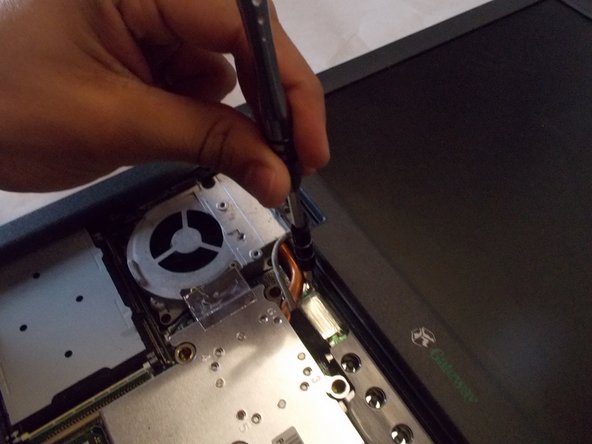

  12. Gateway Solo 1450 Touchpad Replacement: crwdns2935265:012crwdnd2935265:01crwdnd2935265:02crwdne2935265:0 Gateway Solo 1450 Touchpad Replacement: crwdns2935265:012crwdnd2935265:02crwdnd2935265:02crwdne2935265:0
    • Locate where the screen is connected to the laptop's interior.
    • Locate the 2 screws fixing this connection into place.
    • Unscrew the screws holding the connection between the screen and the laptop's interior in place.

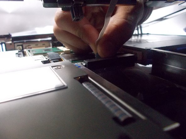

  13. Gateway Solo 1450 Touchpad Replacement: crwdns2935265:013crwdnd2935265:01crwdnd2935265:03crwdne2935265:0 Gateway Solo 1450 Touchpad Replacement: crwdns2935265:013crwdnd2935265:02crwdnd2935265:03crwdne2935265:0 Gateway Solo 1450 Touchpad Replacement: crwdns2935265:013crwdnd2935265:03crwdnd2935265:03crwdne2935265:0
    • Locate the small piece of plastic above the connection between the screen and the laptop's interior.
    • Carefully insert a spudger into this piece of plastic and separate the connection from the laptop's interior.
    • Remove the connection from the laptop's interior.

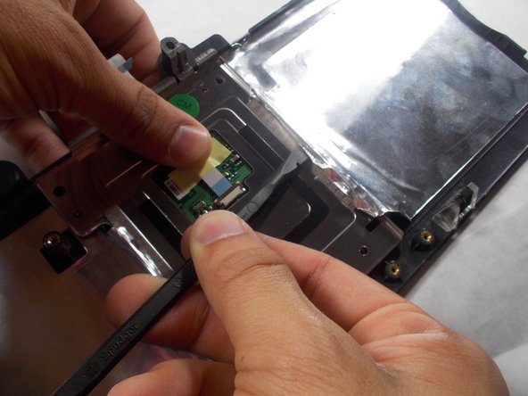

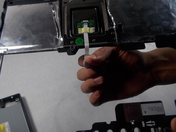

  15. Gateway Solo 1450 Touchpad Replacement: crwdns2935265:016crwdnd2935265:01crwdnd2935265:03crwdne2935265:0 Gateway Solo 1450 Touchpad Replacement: crwdns2935265:016crwdnd2935265:02crwdnd2935265:03crwdne2935265:0 Gateway Solo 1450 Touchpad Replacement: crwdns2935265:016crwdnd2935265:03crwdnd2935265:03crwdne2935265:0
    • Locate where the touchpad is connected to the laptop's interior. (need pic of interior with frame still on laptop)
    • Disconnect the touchpad from the laptop's interior.
    • Remove the frame containing the touchpad from the laptop.

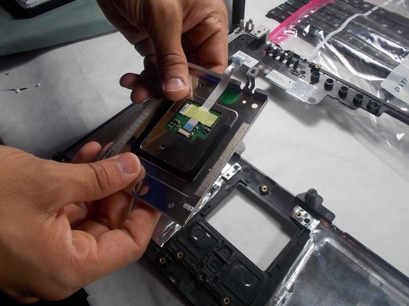

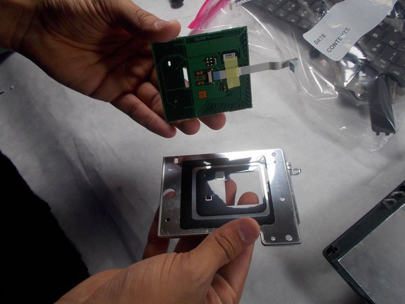

  16. Gateway Solo 1450 Touchpad Replacement: crwdns2935265:017crwdnd2935265:01crwdnd2935265:02crwdne2935265:0 Gateway Solo 1450 Touchpad Replacement: crwdns2935265:017crwdnd2935265:02crwdnd2935265:02crwdne2935265:0
    • Turn the frame over so that the underside of the touchpad is exposed.
    • If there is cooling foil overlapping the touchpad, carefully spudger it off.

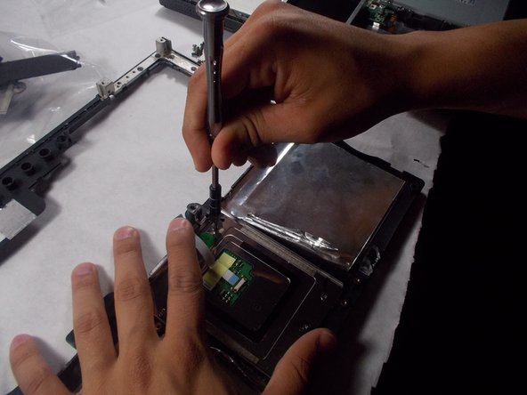

  17. Gateway Solo 1450 Touchpad Replacement: crwdns2935265:018crwdnd2935265:01crwdnd2935265:02crwdne2935265:0 Gateway Solo 1450 Touchpad Replacement: crwdns2935265:018crwdnd2935265:02crwdnd2935265:02crwdne2935265:0
    • Locate the 8 points where the touchpad is fixed to the frame with screws.
    • Unscrew the screws connecting the touchpad to the frame.
  18. Gateway Solo 1450 Touchpad Replacement: crwdns2935265:019crwdnd2935265:01crwdnd2935265:02crwdne2935265:0 Gateway Solo 1450 Touchpad Replacement: crwdns2935265:019crwdnd2935265:02crwdnd2935265:02crwdne2935265:0
    • Remove the touchpad from the laptop's frame.
  19. Gateway Solo 1450 Touchpad Replacement: crwdns2935265:020crwdnd2935265:01crwdnd2935265:02crwdne2935265:0 Gateway Solo 1450 Touchpad Replacement: crwdns2935265:020crwdnd2935265:02crwdnd2935265:02crwdne2935265:0
    • Turn over the touchpad so that the touchpad itself is exposed.
    • Remove the touchpad from the rest of the touchpad assembly.
