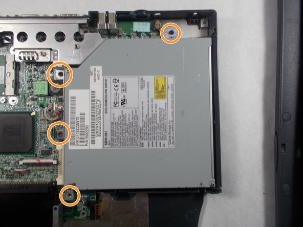

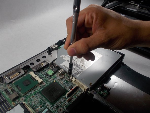

  9. Gateway Solo 1450 Optical Drive Replacement, Optical Drive: crwdns2935265:09crwdnd2935265:01crwdnd2935265:03crwdne2935265:0 Gateway Solo 1450 Optical Drive Replacement, Optical Drive: crwdns2935265:09crwdnd2935265:02crwdnd2935265:03crwdne2935265:0 Gateway Solo 1450 Optical Drive Replacement, Optical Drive: crwdns2935265:09crwdnd2935265:03crwdnd2935265:03crwdne2935265:0
    • Locate the optical drive.
    • Locate the points where the optical drive is secured to the laptop's interior with screws.
    • Unscrew the screws holding the optical drive in place.

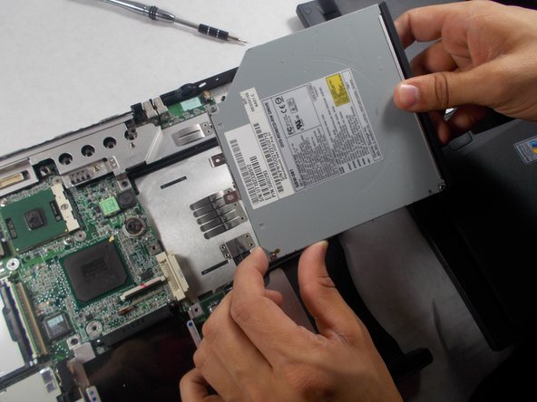

  10. Gateway Solo 1450 Optical Drive Replacement: crwdns2935265:010crwdnd2935265:01crwdnd2935265:02crwdne2935265:0 Gateway Solo 1450 Optical Drive Replacement: crwdns2935265:010crwdnd2935265:02crwdnd2935265:02crwdne2935265:0
    • Remove the optical drive from the laptop's interior.
