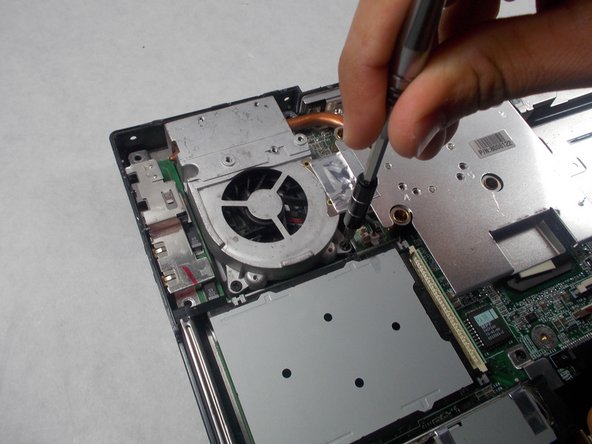

  15. Gateway Solo 1450 Fan Replacement, Fan: crwdns2935265:015crwdnd2935265:01crwdnd2935265:01crwdne2935265:0
    • The fan assembly is located in the top left corner of the laptop's interior.
    • Note that there is a metal protective cover on the fan and a metal plate connected to it at the bottom right.
  16. Gateway Solo 1450 Fan Replacement: crwdns2935265:016crwdnd2935265:01crwdnd2935265:02crwdne2935265:0 Gateway Solo 1450 Fan Replacement: crwdns2935265:016crwdnd2935265:02crwdnd2935265:02crwdne2935265:0

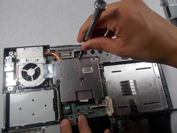

    • Locate the 5 points in which the fan's metal protective cover is fixed in place by screws.
    • Unscrew the screws holding the metal protective cover in place.
  17. Gateway Solo 1450 Fan Replacement: crwdns2935265:017crwdnd2935265:01crwdnd2935265:02crwdne2935265:0 Gateway Solo 1450 Fan Replacement: crwdns2935265:017crwdnd2935265:02crwdnd2935265:02crwdne2935265:0
    • Identify the 7 points in which the metal plate connected to the fan's metal protective covering is fixed into place by screws.
    • Unscrew the screws holding the metal plate into place.
  18. Gateway Solo 1450 Fan Replacement: crwdns2935265:018crwdnd2935265:01crwdnd2935265:02crwdne2935265:0 Gateway Solo 1450 Fan Replacement: crwdns2935265:018crwdnd2935265:02crwdnd2935265:02crwdne2935265:0

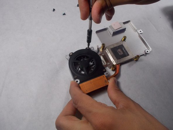

    • Turn over the fan assembly onto its backside so that the fan's metal protective cover is underneath it.
    • Locate the 4 points where the fan is connected to its metal protective cover with screws.
    • Unscrew the screws connecting the fan and its metal protective cover.
  20. Gateway Solo 1450 Fan Replacement: crwdns2935265:020crwdnd2935265:01crwdnd2935265:02crwdne2935265:0 Gateway Solo 1450 Fan Replacement: crwdns2935265:020crwdnd2935265:02crwdnd2935265:02crwdne2935265:0

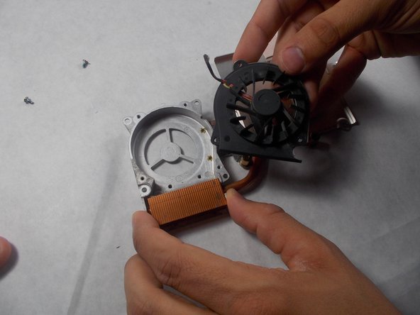

    • Remove the fan from its metal protective cover.
