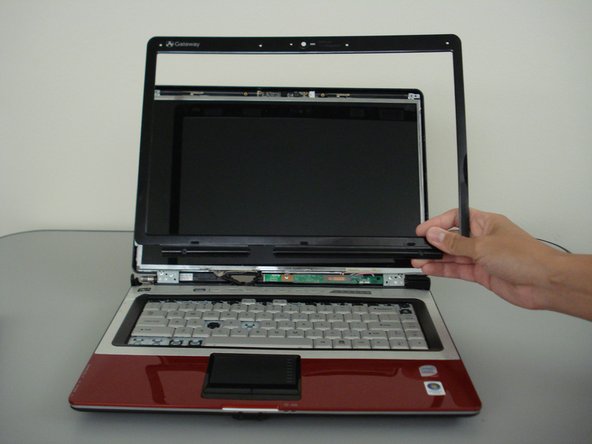

      • Remove the front bezel by prying it off with the wedged end of the spudger.
      • Verify that your spudger does not touch the LCD.

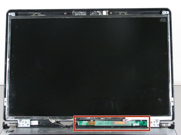

      • The screen inverter is now exposed below the LCD.
    5. Gateway SA1 Screen Replacement: crwdns2935265:07crwdnd2935265:01crwdnd2935265:01crwdne2935265:0
      • Remove the single 3.8mm Phillips screw mounting the screen inverter to the computer.
    6. Gateway SA1 Screen Replacement: crwdns2935265:08crwdnd2935265:01crwdnd2935265:02crwdne2935265:0 Gateway SA1 Screen Replacement: crwdns2935265:08crwdnd2935265:02crwdnd2935265:02crwdne2935265:0
      • Use your finger, or the spudger, to pry the inverter board out.
      • This exposes the wires behind it.
    7. Gateway SA1 Screen Replacement: crwdns2935265:09crwdnd2935265:01crwdnd2935265:01crwdne2935265:0
      • Unplug the LCD back light cables from the right side of the screen inverter.

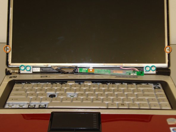

    8. Gateway SA1 Screen Replacement: crwdns2935265:010crwdnd2935265:01crwdnd2935265:02crwdne2935265:0 Gateway SA1 Screen Replacement: crwdns2935265:010crwdnd2935265:02crwdnd2935265:02crwdne2935265:0
      • Remove the six screws that mount the screen to the hinge mounts.
      • Two 2.5 mm Phillips screws.
      • Four 3.8 mm Phillips screws.

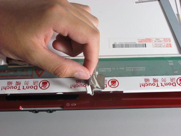

      • Remove the three tape strips that hold down the cables.
      • Be careful not to tear any of the tape. The piece holding down the webcam wires is especially delicate.
