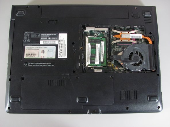

      • Move the latch to the right of the battery to unlock.
    2. Gateway SA1 RAM Replacement: crwdns2935265:02crwdnd2935265:01crwdnd2935265:01crwdne2935265:0
      • Slide the latch on the left directly below the battery to unlock and pull out the battery as shown.
      • The latch must be held in position to remove the battery.

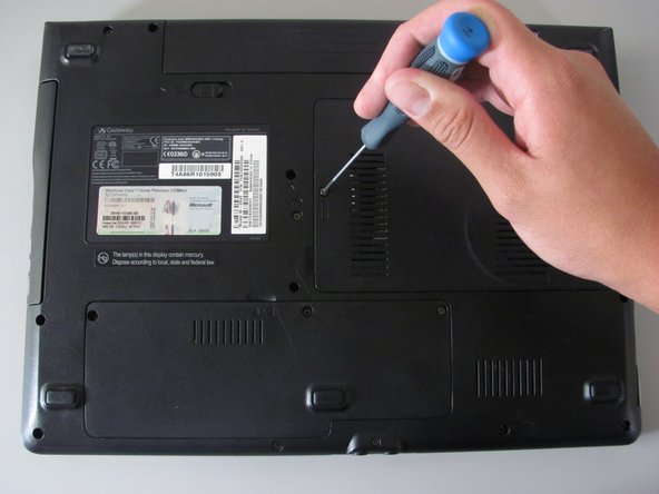

      • Loosen the indicated Philips screw that connects the memory bay cover to the casing.
      • The indicated Philips screw does not come out of the cover.
    2. Gateway SA1 RAM Replacement: crwdns2935265:04crwdnd2935265:01crwdnd2935265:02crwdne2935265:0 Gateway SA1 RAM Replacement: crwdns2935265:04crwdnd2935265:02crwdnd2935265:02crwdne2935265:0
      • Lift and remove the cover using the spudger.

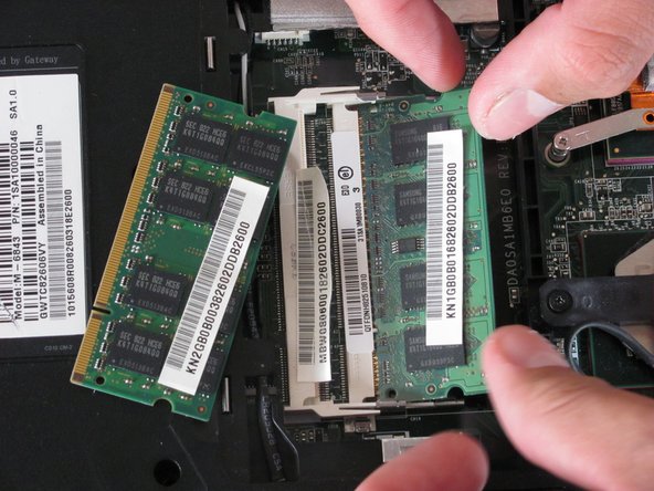

      • Gently press the clip outwards.
      • The module will tilt up and can be pulled out of the slot.
      • There may be another memory module underneath so be sure to remove both.
    4. Gateway SA1 RAM Replacement: crwdns2935265:06crwdnd2935265:01crwdnd2935265:01crwdne2935265:0
      • To insert a new memory, slide the module into the slot at a 30 to 45 degree angle.
      • Place the first module into the bottom slot then the next module into the top slot.
      • These slots are keyed so verify that you are sliding the module in one direction.
      • Verify that the new memory modules are designed for your specific Gateway Laptop.
