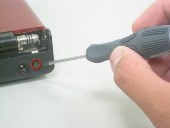

    1. Gateway SA1 Outer Casing Replacement, Outer Casing: crwdns2935265:06crwdnd2935265:01crwdnd2935265:01crwdne2935265:0
      • Remove the twelve 5.9 mm Philips screws from the back cover.
      • Remove one 8.8 mm Philips screw from the back cover.

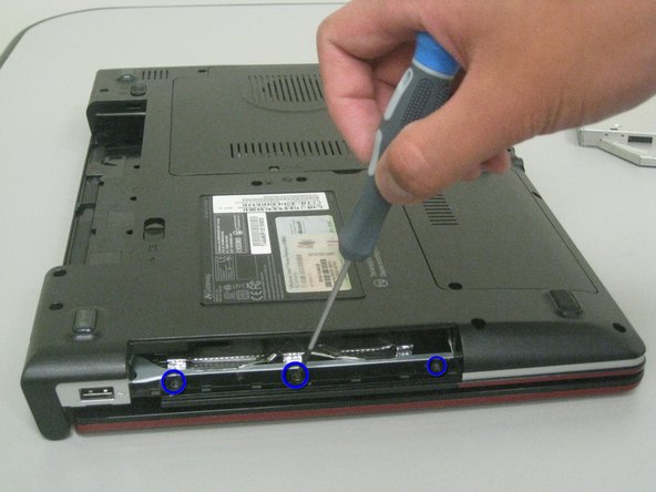

      • Unscrew the two 5.9 mm Philips screws located on the the side closest to the battery.
      • Unscrew the three 3.6 mm Philips screws that are within the Disk drive port.

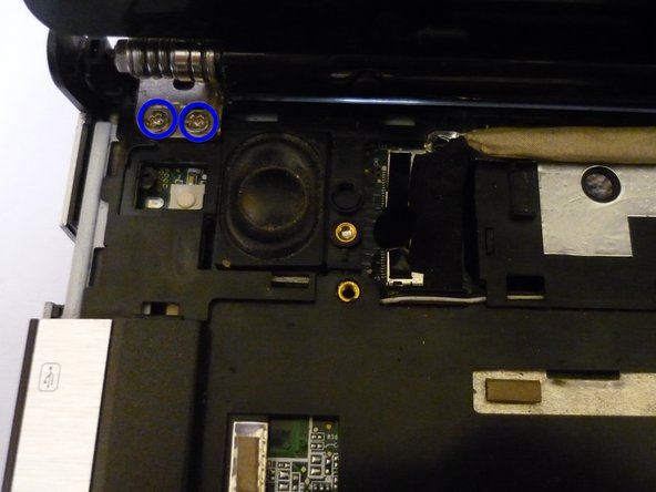

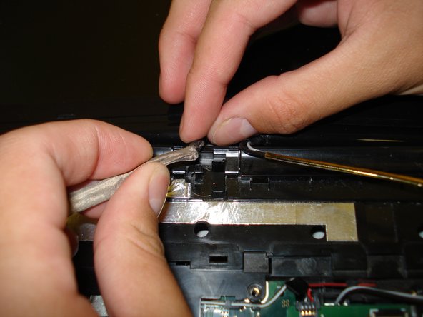

    3. Gateway SA1 Outer Casing Replacement: crwdns2935265:08crwdnd2935265:01crwdnd2935265:02crwdne2935265:0 Gateway SA1 Outer Casing Replacement: crwdns2935265:08crwdnd2935265:02crwdnd2935265:02crwdne2935265:0
      • Remove the hinge covers by lifting each with the sharp point of the spudger.
      • Notice that the middle cover has a different shape and is more difficult to remove.

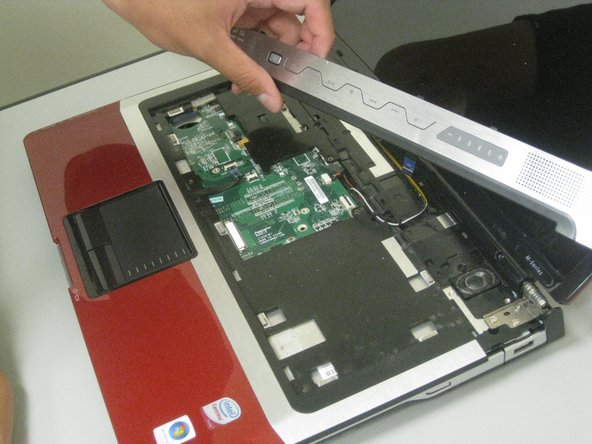

    4. Gateway SA1 Outer Casing Replacement: crwdns2935265:09crwdnd2935265:01crwdnd2935265:03crwdne2935265:0 Gateway SA1 Outer Casing Replacement: crwdns2935265:09crwdnd2935265:02crwdnd2935265:03crwdne2935265:0 Gateway SA1 Outer Casing Replacement: crwdns2935265:09crwdnd2935265:03crwdnd2935265:03crwdne2935265:0
      • There will be a connection underneath the speaker cover.
      • Remove the speaker cover using the spudger.

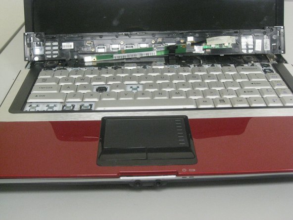

    5. Gateway SA1 Outer Casing Replacement: crwdns2935265:010crwdnd2935265:01crwdnd2935265:01crwdne2935265:0
      • Unscrew the two 3.9 mm Philips screws and remove the keyboard.

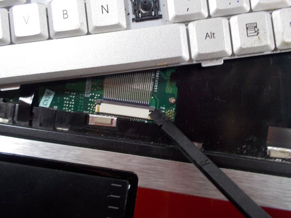

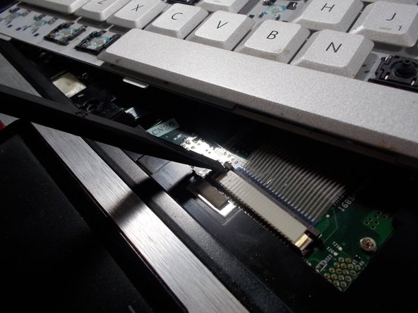

    6. Gateway SA1 Outer Casing Replacement: crwdns2935265:011crwdnd2935265:01crwdnd2935265:03crwdne2935265:0 Gateway SA1 Outer Casing Replacement: crwdns2935265:011crwdnd2935265:02crwdnd2935265:03crwdne2935265:0 Gateway SA1 Outer Casing Replacement: crwdns2935265:011crwdnd2935265:03crwdnd2935265:03crwdne2935265:0
      • Carefully lift the keyboard off from the laptop. It is still attached as shown.
      • Using the spudger, detach the connector by pushing two tabs away from the white connector and then gently pulling the connector away.
      • The brown colored component with the tabs does not come out with the connector.

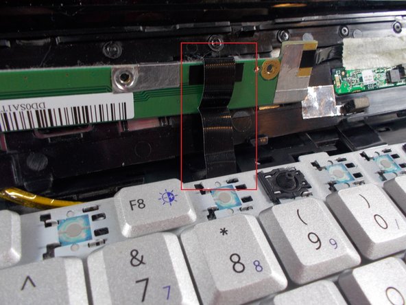

    7. Gateway SA1 Outer Casing Replacement: crwdns2935265:012crwdnd2935265:01crwdnd2935265:03crwdne2935265:0 Gateway SA1 Outer Casing Replacement: crwdns2935265:012crwdnd2935265:02crwdnd2935265:03crwdne2935265:0 Gateway SA1 Outer Casing Replacement: crwdns2935265:012crwdnd2935265:03crwdnd2935265:03crwdne2935265:0
      • Lift up the black tab and gently pull out the connector.

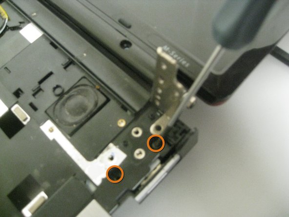

    12. Gateway SA1 Outer Casing Replacement: crwdns2935265:017crwdnd2935265:01crwdnd2935265:03crwdne2935265:0 Gateway SA1 Outer Casing Replacement: crwdns2935265:017crwdnd2935265:02crwdnd2935265:03crwdne2935265:0 Gateway SA1 Outer Casing Replacement: crwdns2935265:017crwdnd2935265:03crwdnd2935265:03crwdne2935265:0
      • Remove the four 5.9 mm Philips screws as indicated:
      • There is one somewhat hidden screw on the left side under the screen hinge, and one to the right of the (left)speaker, right/top side of the video port on mobo.
      • There are two similarly positioned screws on the right side.

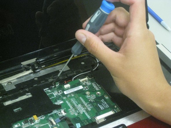

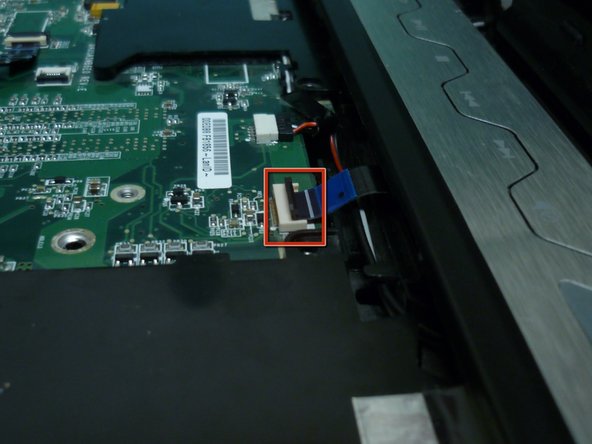

    13. Gateway SA1 Outer Casing Replacement: crwdns2935265:018crwdnd2935265:01crwdnd2935265:02crwdne2935265:0 Gateway SA1 Outer Casing Replacement: crwdns2935265:018crwdnd2935265:02crwdnd2935265:02crwdne2935265:0
      • The following steps (18 - 20) explain how to remove the three indicated connections.
      • The order is Blue, Violet, Orange.
      • Lift the white tab up and gently take out the connector.

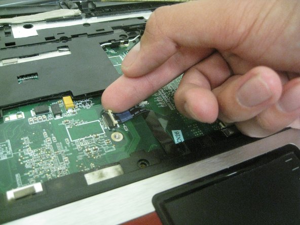

    14. Gateway SA1 Outer Casing Replacement: crwdns2935265:019crwdnd2935265:01crwdnd2935265:01crwdne2935265:0
      • Use the spudger to pull off the black attachment.
    15. Gateway SA1 Outer Casing Replacement: crwdns2935265:020crwdnd2935265:01crwdnd2935265:01crwdne2935265:0
      • Lift and pull the black tab upward until it becomes unattached.
      • Some force may be required.
