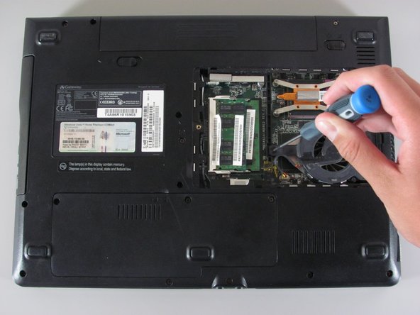

    1. Gateway SA1 Cooling Fan Replacement, Cooling Fan: crwdns2935265:03crwdnd2935265:01crwdnd2935265:02crwdne2935265:0 Gateway SA1 Cooling Fan Replacement, Cooling Fan: crwdns2935265:03crwdnd2935265:02crwdnd2935265:02crwdne2935265:0
      • Unscrew the indicated Philips screw.
      • Screw cannot be completely removed from cover.
    2. Gateway SA1 Cooling Fan Replacement: crwdns2935265:04crwdnd2935265:01crwdnd2935265:01crwdne2935265:0
      • Use the spudger to pry open the cover.
      • There will be three tabs on each side except for the side with the screw.
    3. Gateway SA1 Cooling Fan Replacement: crwdns2935265:05crwdnd2935265:01crwdnd2935265:02crwdne2935265:0 Gateway SA1 Cooling Fan Replacement: crwdns2935265:05crwdnd2935265:02crwdnd2935265:02crwdne2935265:0
      • Unscrew the six indicated Philips screws.
      • These screws cannot be completely removed from the cooling fan component.
    4. Gateway SA1 Cooling Fan Replacement: crwdns2935265:06crwdnd2935265:01crwdnd2935265:01crwdne2935265:0
      • Unplug the shown cable attaching the cooling fan to the computer.
    5. Gateway SA1 Cooling Fan Replacement: crwdns2935265:07crwdnd2935265:01crwdnd2935265:01crwdne2935265:0
      • You are now able to remove the cooling fan.
