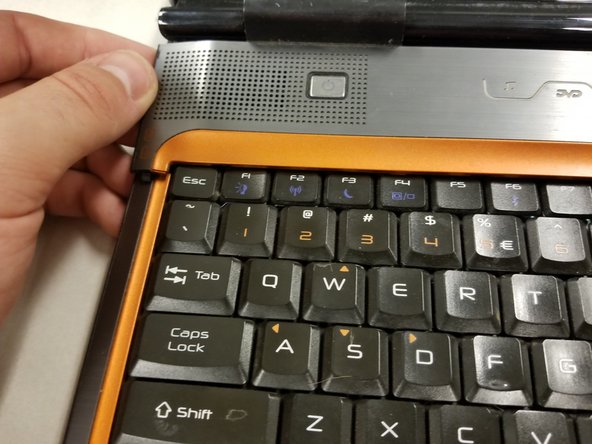

  3. Gateway P-7805u Keyboard Replacement: crwdns2935265:03crwdnd2935265:01crwdnd2935265:02crwdne2935265:0 Gateway P-7805u Keyboard Replacement: crwdns2935265:03crwdnd2935265:02crwdnd2935265:02crwdne2935265:0
    • Using a pair of tweezers, your fingers, or a screw driver, carefully dig into the laptop cover and apply force to pop it out.
    • Do this on the right and left sides of the cover.
  4. Gateway P-7805u Keyboard Replacement: crwdns2935265:04crwdnd2935265:01crwdnd2935265:01crwdne2935265:0
    • Pull up the keyboard with your finger.
