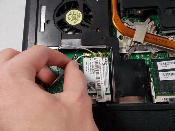

    • Turn your laptop upside down and remove the five Philips #0 (5mm) screws for the cover of the WiFi Card.
    • Make sure to unplug your laptop charger, as removing the WiFi while the device is charging may damage the WiFi and or the charger.
  2. Gateway P-6831FX WiFi Card Replacement: crwdns2935265:02crwdnd2935265:01crwdnd2935265:02crwdne2935265:0 Gateway P-6831FX WiFi Card Replacement: crwdns2935265:02crwdnd2935265:02crwdnd2935265:02crwdne2935265:0
    • Gently pull the cover away from the device.

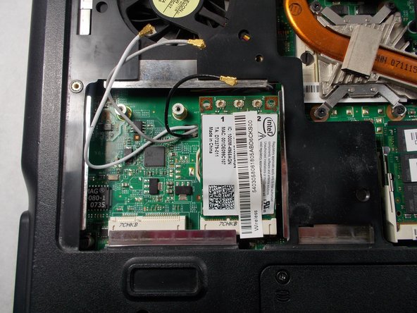

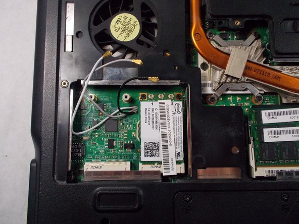

  3. Gateway P-6831FX WiFi Card Replacement: crwdns2935265:03crwdnd2935265:01crwdnd2935265:03crwdne2935265:0 Gateway P-6831FX WiFi Card Replacement: crwdns2935265:03crwdnd2935265:02crwdnd2935265:03crwdne2935265:0 Gateway P-6831FX WiFi Card Replacement: crwdns2935265:03crwdnd2935265:03crwdnd2935265:03crwdne2935265:0
    • Remove the three wires above the WiFi Card.
    • Take note of the color for each wire and it's corresponding location.

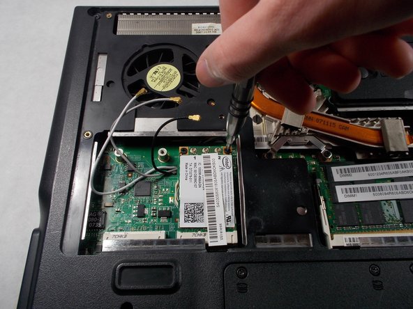

  4. Gateway P-6831FX WiFi Card Replacement: crwdns2935265:04crwdnd2935265:01crwdnd2935265:03crwdne2935265:0 Gateway P-6831FX WiFi Card Replacement: crwdns2935265:04crwdnd2935265:02crwdnd2935265:03crwdne2935265:0 Gateway P-6831FX WiFi Card Replacement: crwdns2935265:04crwdnd2935265:03crwdnd2935265:03crwdne2935265:0
    • Remove the two Phillips #0 (2mm) screws above the WiFi card.
    • The WiFi Card will lift up once the screws are removed.
  5. Gateway P-6831FX WiFi Card Replacement: crwdns2935265:05crwdnd2935265:01crwdnd2935265:02crwdne2935265:0 Gateway P-6831FX WiFi Card Replacement: crwdns2935265:05crwdnd2935265:02crwdnd2935265:02crwdne2935265:0
    • With the WiFi Card lifted up, gently pull the WiFi Card out of the socket and remove it from the device.
