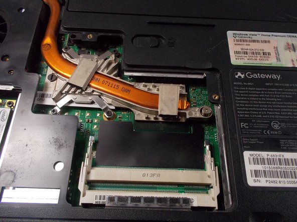

    • Turn your laptop upside down and remove the five Philips #0 (5mm) screws for the cover of the RAM.
    • Make sure to unplug your laptop charger, as removing the RAM while the device is charging may damage the RAM and or the charger.
  2. Gateway P-6831FX RAM Replacement: crwdns2935265:02crwdnd2935265:01crwdnd2935265:02crwdne2935265:0 Gateway P-6831FX RAM Replacement: crwdns2935265:02crwdnd2935265:02crwdnd2935265:02crwdne2935265:0
    • Gently pull the cover away from the device.
    • Set the cover aside for now, until reassembly.
  3. Gateway P-6831FX RAM Replacement: crwdns2935265:03crwdnd2935265:01crwdnd2935265:03crwdne2935265:0 Gateway P-6831FX RAM Replacement: crwdns2935265:03crwdnd2935265:02crwdnd2935265:03crwdne2935265:0 Gateway P-6831FX RAM Replacement: crwdns2935265:03crwdnd2935265:03crwdnd2935265:03crwdne2935265:0
    • Pull the metal tabs and lift the first RAM stick out of the socket.
  4. Gateway P-6831FX RAM Replacement: crwdns2935265:04crwdnd2935265:01crwdnd2935265:03crwdne2935265:0 Gateway P-6831FX RAM Replacement: crwdns2935265:04crwdnd2935265:02crwdnd2935265:03crwdne2935265:0 Gateway P-6831FX RAM Replacement: crwdns2935265:04crwdnd2935265:03crwdnd2935265:03crwdne2935265:0
    • Repeat Step 3 to remove the second RAM stick.
