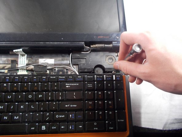

    • Open your laptop and lay it flat
    • Locate the speaker grill/interaction bar.
  2. Gateway P-6831FX Keyboard Replacement: crwdns2935265:02crwdnd2935265:01crwdnd2935265:03crwdne2935265:0 Gateway P-6831FX Keyboard Replacement: crwdns2935265:02crwdnd2935265:02crwdnd2935265:03crwdne2935265:0 Gateway P-6831FX Keyboard Replacement: crwdns2935265:02crwdnd2935265:03crwdnd2935265:03crwdne2935265:0
    • Remove the speaker grill/interaction bar by pulling up at both edges.

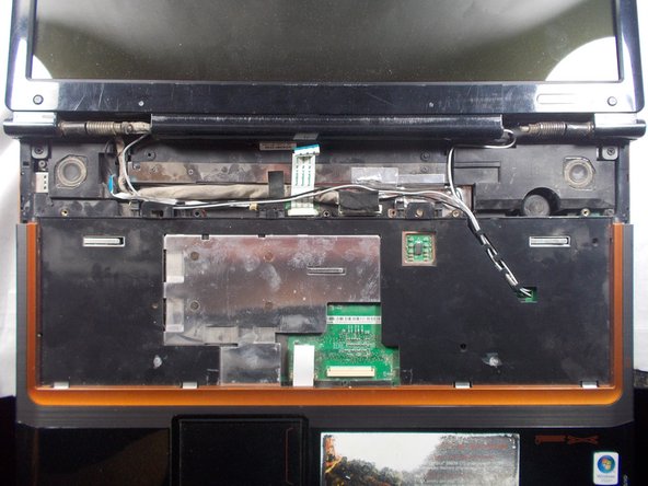

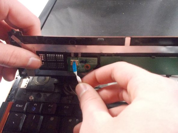

    • Detach the two ribbon cables on the underside of the keyboard.
  4. Gateway P-6831FX Keyboard Replacement: crwdns2935265:04crwdnd2935265:01crwdnd2935265:02crwdne2935265:0 Gateway P-6831FX Keyboard Replacement: crwdns2935265:04crwdnd2935265:02crwdnd2935265:02crwdne2935265:0
    • Remove the five Philips #0 (3mm) screws securing the keyboard in place.
  5. Gateway P-6831FX Keyboard Replacement: crwdns2935265:05crwdnd2935265:01crwdnd2935265:01crwdne2935265:0
    • Pull the keyboard up and away from you.

    • Remove the ribbon cable attached underneath to the keyboard.
