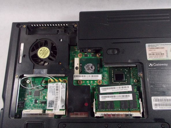

    • Turn your laptop upside down and remove the five Philips #0 (5mm) screws for the cover of the Heatsink.
    • Make sure to unplug your laptop charger, as removing the Heatsink while the device is charging may damage the Heatsink and or the charger.
  2. Gateway P-6831FX Heatsink Replacement: crwdns2935265:02crwdnd2935265:01crwdnd2935265:01crwdne2935265:0
    • Gently pull the cover away from the device.

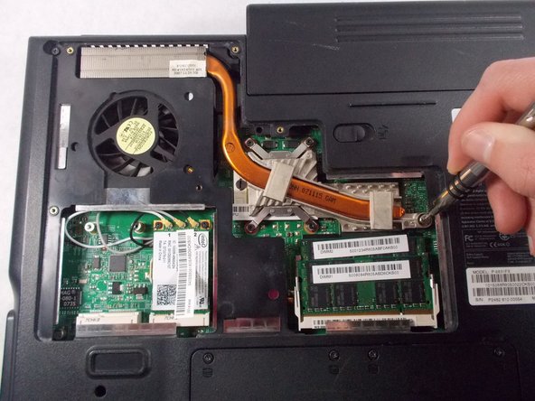

  3. Gateway P-6831FX Heatsink Replacement: crwdns2935265:03crwdnd2935265:01crwdnd2935265:02crwdne2935265:0 Gateway P-6831FX Heatsink Replacement: crwdns2935265:03crwdnd2935265:02crwdnd2935265:02crwdne2935265:0
    • Remove the five Phillips #0 (5mm) screws around the Heatsink.
  4. Gateway P-6831FX Heatsink Replacement: crwdns2935265:04crwdnd2935265:01crwdnd2935265:02crwdne2935265:0 Gateway P-6831FX Heatsink Replacement: crwdns2935265:04crwdnd2935265:02crwdnd2935265:02crwdne2935265:0
    • Gently pull the Heatsink up and away from the chassis.
