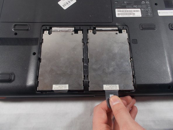

    • Turn your laptop upside down and remove the four Philips #0 (5mm) screws for the cover of the hard drive.
    • Make sure to unplug your laptop charger, as removing the hard drive while the device is charging may damage the hard drive and or the charger.
  2. Gateway P-6831FX Hard Drive Replacement: crwdns2935265:02crwdnd2935265:01crwdnd2935265:02crwdne2935265:0 Gateway P-6831FX Hard Drive Replacement: crwdns2935265:02crwdnd2935265:02crwdnd2935265:02crwdne2935265:0
    • Gently pull the cover away from the device.
    • Set the cover aside for now, until reassembly.

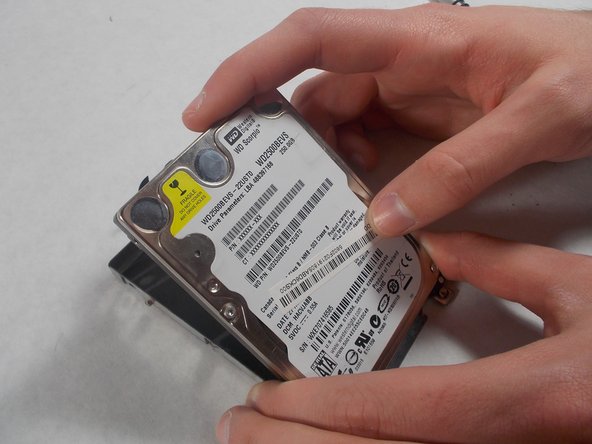

  3. Gateway P-6831FX Hard Drive Replacement: crwdns2935265:03crwdnd2935265:01crwdnd2935265:02crwdne2935265:0 Gateway P-6831FX Hard Drive Replacement: crwdns2935265:03crwdnd2935265:02crwdnd2935265:02crwdne2935265:0
    • Pull the plastic tab as shown to remove the hard drive from the device.

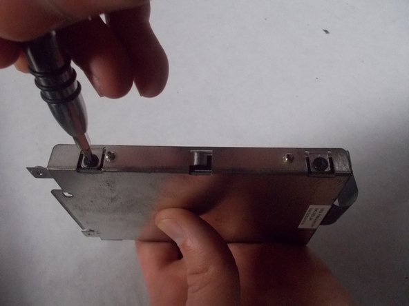

  4. Gateway P-6831FX Hard Drive Replacement: crwdns2935265:04crwdnd2935265:01crwdnd2935265:02crwdne2935265:0 Gateway P-6831FX Hard Drive Replacement: crwdns2935265:04crwdnd2935265:02crwdnd2935265:02crwdne2935265:0
    • Remove the four Philips #0 (3mm) screws around the case for the hard drive. There will be two screws and the left and right side.

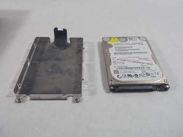

  5. Gateway P-6831FX Hard Drive Replacement: crwdns2935265:05crwdnd2935265:01crwdnd2935265:03crwdne2935265:0 Gateway P-6831FX Hard Drive Replacement: crwdns2935265:05crwdnd2935265:02crwdnd2935265:03crwdne2935265:0 Gateway P-6831FX Hard Drive Replacement: crwdns2935265:05crwdnd2935265:03crwdnd2935265:03crwdne2935265:0
    • Remove the hard drive from the case.
