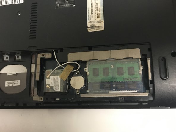

  6. Gateway NV55C49u Display Replacement: crwdns2935265:06crwdnd2935265:01crwdnd2935265:01crwdne2935265:0
    • Remove the four 3.0mm Phillips #0 screws from the battery compartment.
  7. Gateway NV55C49u Display Replacement: crwdns2935265:07crwdnd2935265:01crwdnd2935265:01crwdne2935265:0
    • Remove the two 6.0mm #00 Phillips screws from the area under the back cover.
  8. Gateway NV55C49u Display Replacement: crwdns2935265:08crwdnd2935265:01crwdnd2935265:01crwdne2935265:0
    • Remove the nine 6.0mm #00 Phillips screws from the back of the laptop.

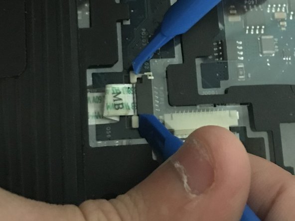

  10. Gateway NV55C49u Display Replacement: crwdns2935265:010crwdnd2935265:01crwdnd2935265:01crwdne2935265:0
    • Once the keyboard is loose, slowly lift the keyboard away from the laptop.
    • There will be a single ribbon cable connecting the keyboard to the laptop body. Use two plastic opening tools to loosen the fastener,
    • After the fastener is loose, gently disconnect the cable.
    • Ribbon cables should come out easily once the fasteners are loose. Do not apply too much pressure.

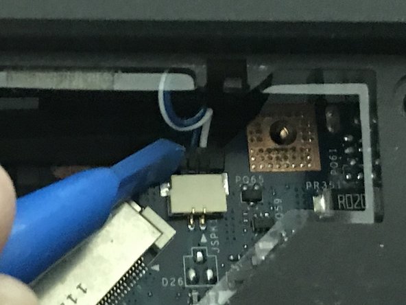

  15. Gateway NV55C49u Display Replacement: crwdns2935265:015crwdnd2935265:01crwdnd2935265:01crwdne2935265:0
    • Remove the ribbon wire that connects the display to the motherboard using two plastic opening tools.
  16. Gateway NV55C49u Display Replacement: crwdns2935265:016crwdnd2935265:01crwdnd2935265:02crwdne2935265:0 Gateway NV55C49u Display Replacement: crwdns2935265:016crwdnd2935265:02crwdnd2935265:02crwdne2935265:0
    • Remove the two 4.0mm #00 Phillips screws from both the top right and top left of the exposed laptop body.
    • The display is now fully disconnected.
