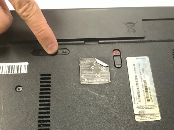

    • Flip the laptop bottom side up.
  2. Gateway NV55C49u Battery Replacement: crwdns2935265:02crwdnd2935265:01crwdnd2935265:01crwdne2935265:0
    • Switch the battery lock to show a red background with an unlock symbol
  3. Gateway NV55C49u Battery Replacement: crwdns2935265:03crwdnd2935265:01crwdnd2935265:02crwdne2935265:0 Gateway NV55C49u Battery Replacement: crwdns2935265:03crwdnd2935265:02crwdnd2935265:02crwdne2935265:0
    • Flip the switch with the battery symbol on it.
    • The battery should eject if done correctly.
  4. Gateway NV55C49u Battery Replacement: crwdns2935265:04crwdnd2935265:01crwdnd2935265:01crwdne2935265:0
    • Remove the battery by lifting the battery out.
  5. Gateway NV55C49u Battery Replacement: crwdns2935265:05crwdnd2935265:01crwdnd2935265:01crwdne2935265:0
