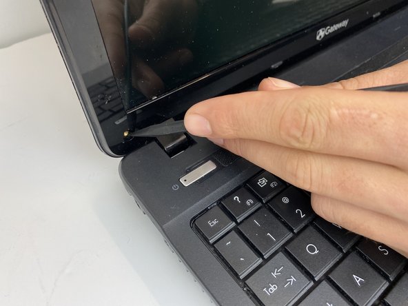

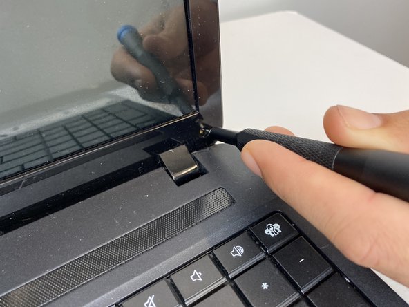

  3. Gateway NE56R27u Screen Replacement, Screen: crwdns2935265:03crwdnd2935265:01crwdnd2935265:03crwdne2935265:0 Gateway NE56R27u Screen Replacement, Screen: crwdns2935265:03crwdnd2935265:02crwdnd2935265:03crwdne2935265:0 Gateway NE56R27u Screen Replacement, Screen: crwdns2935265:03crwdnd2935265:03crwdnd2935265:03crwdne2935265:0
    • Using the spudger, remove the protective caps for the screen to expose the screws.
    • Using the Phillips #000 screwdriver, unscrew the bottom two 1mm screws.
  4. Gateway NE56R27u Screen Replacement: crwdns2935265:04crwdnd2935265:01crwdnd2935265:03crwdne2935265:0 Gateway NE56R27u Screen Replacement: crwdns2935265:04crwdnd2935265:02crwdnd2935265:03crwdne2935265:0 Gateway NE56R27u Screen Replacement: crwdns2935265:04crwdnd2935265:03crwdnd2935265:03crwdne2935265:0
    • Using the opening pick in between the front cover and bezel, gently loosen and lift the plastic bezel from the screen and backing.
