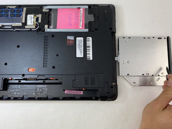

    • Using the flat end of the spudger, slide the optical drive out.

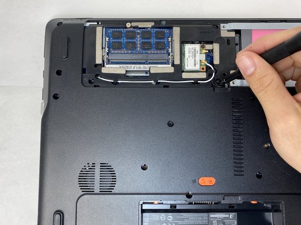

    • Using the hook end of a halberd spudger, gently pry up the black and white wires from the wireless card.

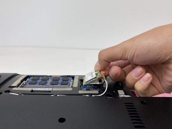

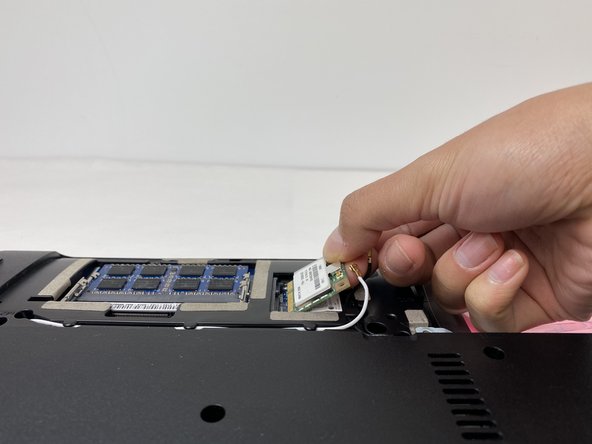

    • Using the flat side of the spudger, pry the wireless card out of its slot.
    • The card will then pop upwards at a 45 degree angle. At this point, gently pull the card out.

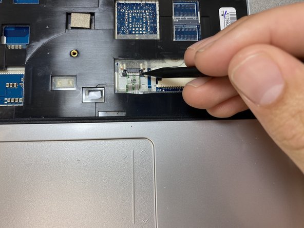

    • Flip the laptop back over.
    • Once the keyboard is removed, use the pointed-end of the spudger to release the touch pad cable.
    • Gently slide both sides of the clip upward towards the screen in order to release the cable.

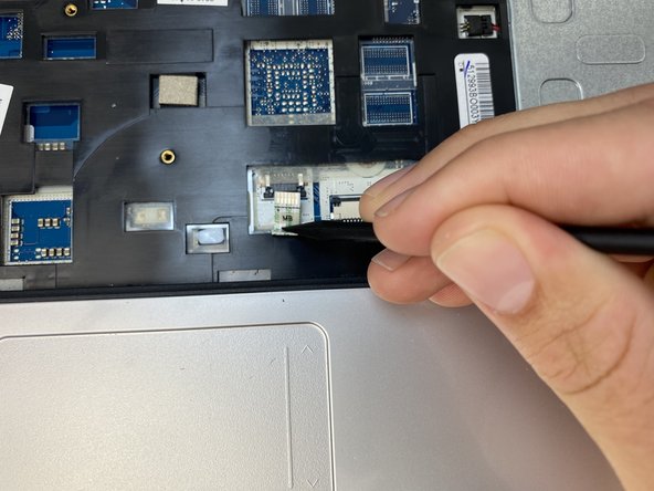

    • Using the spudger, gently slide the clamp holding the MS cable upward towards the screen. Carefully remove the cable from its housing.

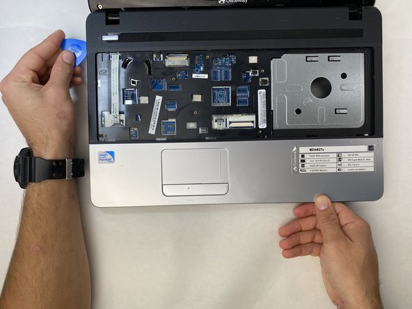

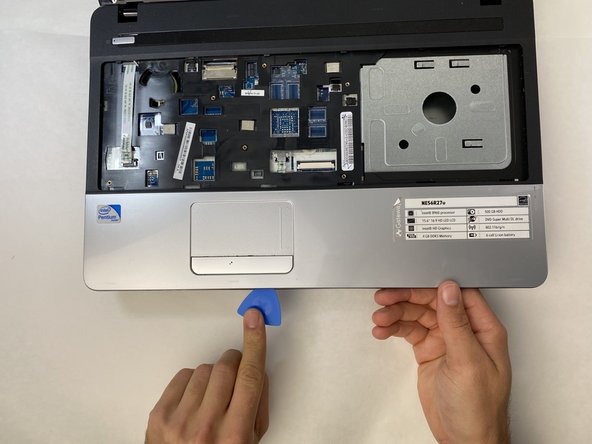

    • Using the opening pick, carefully pry the palm rest assembly upwards.
    • Work the pick around the perimeter until all of the clips are released.

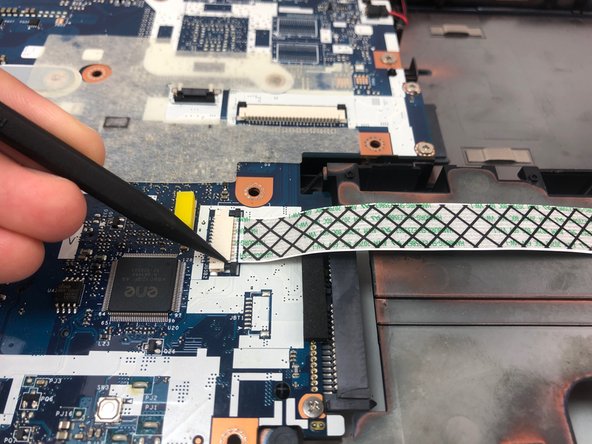

    • Using the plastic spudger, release the cable from the ZIF connectors and remove all four ribbon cables on the motherboard.

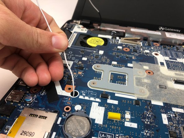

  20. Gateway NE56R27u Motherboard Replacement: crwdns2935265:020crwdnd2935265:01crwdnd2935265:03crwdne2935265:0 Gateway NE56R27u Motherboard Replacement: crwdns2935265:020crwdnd2935265:02crwdnd2935265:03crwdne2935265:0 Gateway NE56R27u Motherboard Replacement: crwdns2935265:020crwdnd2935265:03crwdnd2935265:03crwdne2935265:0
    • Remove the tape holding the white wire and gently pull it out of its hole.

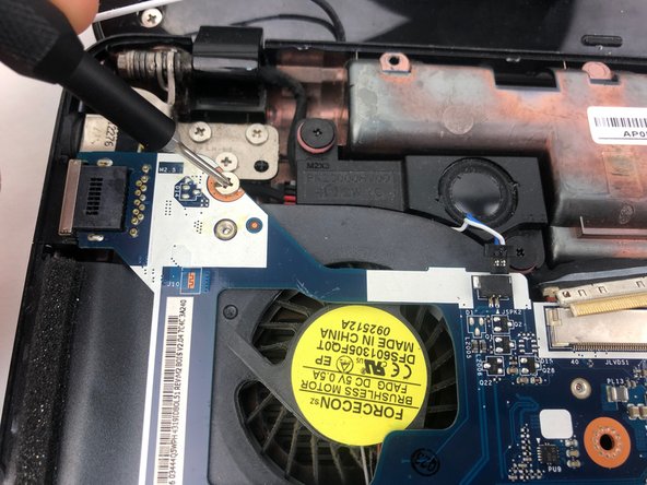

    • Use the Phillips #000 driver to remove the two remaining 3mm silver screws.

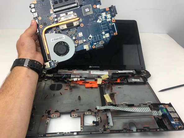

    • Gently lift the motherboard towards the screen.
    • Avoid contact with the connecting cable. Force will cause damage to the cable.
  24. Gateway NE56R27u Motherboard Replacement: crwdns2935265:024crwdnd2935265:01crwdnd2935265:03crwdne2935265:0 Gateway NE56R27u Motherboard Replacement: crwdns2935265:024crwdnd2935265:02crwdnd2935265:03crwdne2935265:0 Gateway NE56R27u Motherboard Replacement: crwdns2935265:024crwdnd2935265:03crwdnd2935265:03crwdne2935265:0

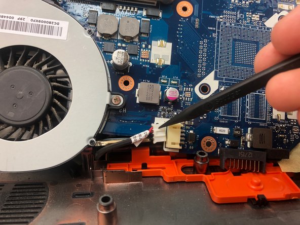

    • Use the spudger to disconnect the last cable holding the motherboard to the system board.
    • Lift the motherboard straight up, being careful not to damage the fan or other sensitive parts.
