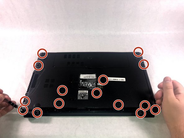

  3. Gateway NE52214U Motherboard Replacement, Upper Case: crwdns2935265:03crwdnd2935265:01crwdnd2935265:02crwdne2935265:0 Gateway NE52214U Motherboard Replacement, Upper Case: crwdns2935265:03crwdnd2935265:02crwdnd2935265:02crwdne2935265:0
    • After removing the battery, remove 15 7mm screws using the Phillip #1 Screwdriver.

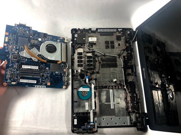

  6. Gateway NE52214U Motherboard Replacement, Motherboard: crwdns2935265:06crwdnd2935265:01crwdnd2935265:01crwdne2935265:0
    • Remove the twelve 3mm screws using the Phillips #00 screwdriver.
  7. Gateway NE52214U Motherboard Replacement: crwdns2935265:07crwdnd2935265:01crwdnd2935265:02crwdne2935265:0 Gateway NE52214U Motherboard Replacement: crwdns2935265:07crwdnd2935265:02crwdnd2935265:02crwdne2935265:0
    • Gently lift and remove the motherboard off of device.
    • This will also remove the fan from the device but it will remain attached to the motherboard.
