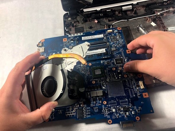

  6. Gateway NE52214U Fan Replacement, Motherboard: crwdns2935265:06crwdnd2935265:01crwdnd2935265:01crwdne2935265:0
    • Remove the twelve 3mm screws using the Phillips #00 screwdriver.
  7. Gateway NE52214U Fan Replacement: crwdns2935265:07crwdnd2935265:01crwdnd2935265:02crwdne2935265:0 Gateway NE52214U Fan Replacement: crwdns2935265:07crwdnd2935265:02crwdnd2935265:02crwdne2935265:0
    • Gently lift and remove the motherboard off of device.
    • This will also remove the fan from the device but it will remain attached to the motherboard.
  8. Gateway NE52214U Fan Replacement, Fan: crwdns2935265:08crwdnd2935265:01crwdnd2935265:01crwdne2935265:0
    • Remove the four 3mm screws attaching the fan to motherboard using the Phillips #00 screwdriver.
  9. Gateway NE52214U Fan Replacement: crwdns2935265:09crwdnd2935265:01crwdnd2935265:02crwdne2935265:0 Gateway NE52214U Fan Replacement: crwdns2935265:09crwdnd2935265:02crwdnd2935265:02crwdne2935265:0
    • Gently lift the fan and disconnect the fan from the motherboard.
    • Remove the fan from the device.
