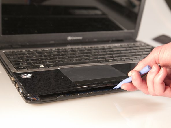

    • Separate the bottom panel from the touchpad assembly by inserting a plastic opening tool between them on all four sides.

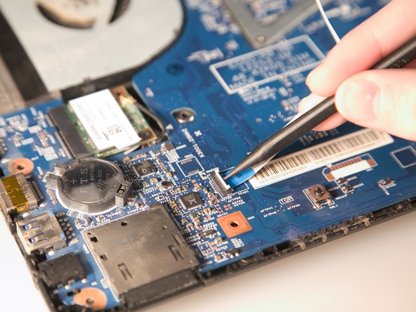

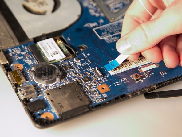

  8. Gateway NE52203u USB Port Replacement: crwdns2935265:08crwdnd2935265:01crwdnd2935265:03crwdne2935265:0 Gateway NE52203u USB Port Replacement: crwdns2935265:08crwdnd2935265:02crwdnd2935265:03crwdne2935265:0 Gateway NE52203u USB Port Replacement: crwdns2935265:08crwdnd2935265:03crwdnd2935265:03crwdne2935265:0
    • Disconnect the two ZIF ports that attach the touchpad assembly to the motherboard.
    • First flip open the flap covering the ribbon using a spudger or fingernail.
    • Second gently pull the ribbon away from the port.
  9. Gateway NE52203u USB Port Replacement, USB Port: crwdns2935265:09crwdnd2935265:01crwdnd2935265:02crwdne2935265:0 Gateway NE52203u USB Port Replacement, USB Port: crwdns2935265:09crwdnd2935265:02crwdnd2935265:02crwdne2935265:0
    • Using a spudger, pry the ZIF connector upwards.
