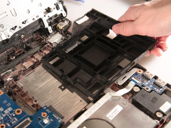

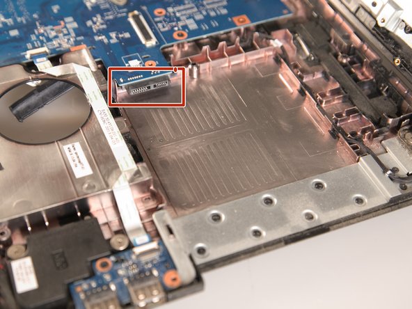

  9. Gateway NE52203u Optical Drive Replacement, Optical Drive: crwdns2935265:09crwdnd2935265:01crwdnd2935265:03crwdne2935265:0 Gateway NE52203u Optical Drive Replacement, Optical Drive: crwdns2935265:09crwdnd2935265:02crwdnd2935265:03crwdne2935265:0 Gateway NE52203u Optical Drive Replacement, Optical Drive: crwdns2935265:09crwdnd2935265:03crwdnd2935265:03crwdne2935265:0
    • Grasp the plastic placeholder firmly and slide it out of the computer.
    • When inserting replacement optical drive, use the port at the back left of the open space.
