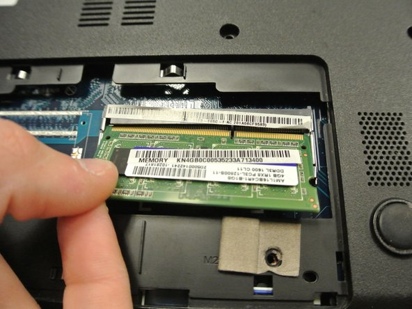

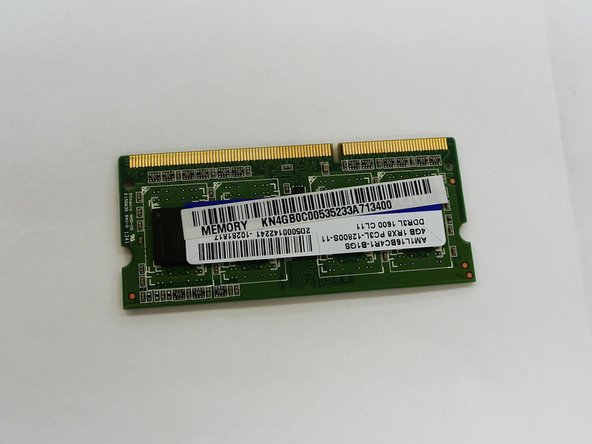

  6. Gateway NE51006u RAM Replacement, RAM: crwdns2935265:06crwdnd2935265:01crwdnd2935265:03crwdne2935265:0 Gateway NE51006u RAM Replacement, RAM: crwdns2935265:06crwdnd2935265:02crwdnd2935265:03crwdne2935265:0 Gateway NE51006u RAM Replacement, RAM: crwdns2935265:06crwdnd2935265:03crwdnd2935265:03crwdne2935265:0
    • Use your fingers to pull the two metal hinges on either side of the RAM card.
    • From here the card should lift upwards and pull off of the device easily.
