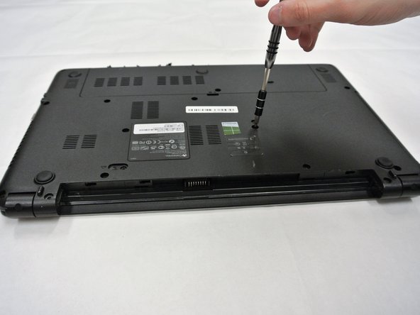

    • Use a PH0 Phillips head screwdriver to remove the 9.0 mm screw on the rectangular panel underneath the device.

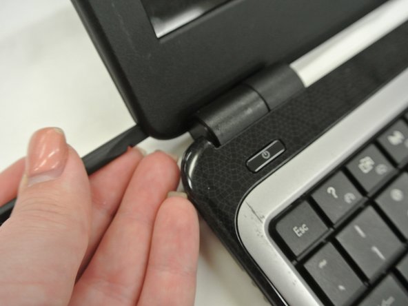

    • Remove the black screw covers covering the 4.2 mm screws located inside of the cylindrical hinges at the bottom corners of the screen housing, then use a PH0 Philips head screwdriver to unscrew them.

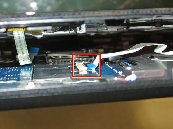

    • After prying the keyboard unit off of the base, Lift the white, hinged covers connected to the three ribbons shown and pull gently to disconnect.
    • When putting the laptop back together, lift the hinged covers and connect the ribbons before dropping the hinged covers back down.

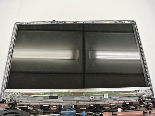

    • Use a plastic opening tool or spudger to remove the plastic frame around the LCD screen. Do this by pressing the wedge in between the crease found in between the two halves of the screen casing.
    • You will hear a soft click and feel the connection between the two points break as you run the tool around the sides of screen casing.

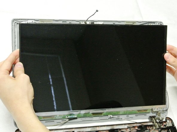

    • Use a PH0 Phillips head to remove four 3.4mm black screws. Remove the screen from the casing before moving on to the next step.
  15. Gateway NE51006u LCD Screen Replacement: crwdns2935265:015crwdnd2935265:01crwdnd2935265:03crwdne2935265:0 Gateway NE51006u LCD Screen Replacement: crwdns2935265:015crwdnd2935265:02crwdnd2935265:03crwdne2935265:0 Gateway NE51006u LCD Screen Replacement: crwdns2935265:015crwdnd2935265:03crwdnd2935265:03crwdne2935265:0

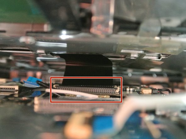

    • Peel the tape off the cable connected to the back of the LCD screen and unplug the cable which is connected to the bottom. The screen should now be fully removed from the laptop casing.
