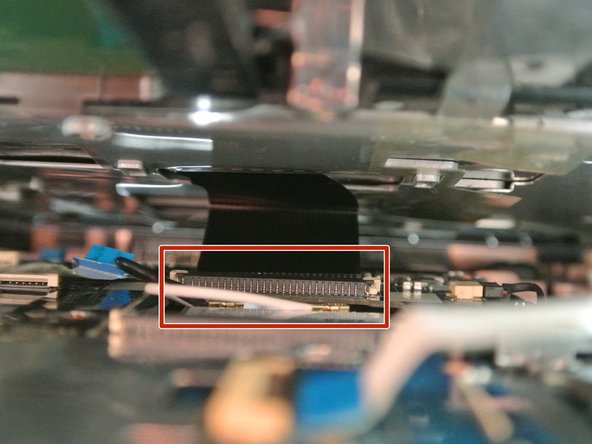

  10. Gateway NE51006u CPU Fan Replacement: crwdns2935265:010crwdnd2935265:01crwdnd2935265:03crwdne2935265:0 Gateway NE51006u CPU Fan Replacement: crwdns2935265:010crwdnd2935265:02crwdnd2935265:03crwdne2935265:0 Gateway NE51006u CPU Fan Replacement: crwdns2935265:010crwdnd2935265:03crwdnd2935265:03crwdne2935265:0
    • After prying the keyboard unit off of the base, Lift the white, hinged covers connected to the three ribbons shown and pull gently to disconnect.
    • When putting the laptop back together, lift the hinged covers and connect the ribbons before dropping the hinged covers back down.

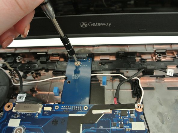

    • Disconnect the wires that are connected to the Wireless Lan chip.
    • Use the PH0 Philips head screwdriver to remove the 9.0 mm screw that is connected to the Wireless Lan chip in the right upper corner. Then remove the CPU by angling it upwards and pulling it towards the laptop screen.

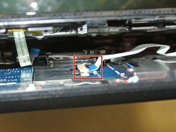

  12. Gateway NE51006u CPU Fan Replacement: crwdns2935265:012crwdnd2935265:01crwdnd2935265:03crwdne2935265:0 Gateway NE51006u CPU Fan Replacement: crwdns2935265:012crwdnd2935265:02crwdnd2935265:03crwdne2935265:0 Gateway NE51006u CPU Fan Replacement: crwdns2935265:012crwdnd2935265:03crwdnd2935265:03crwdne2935265:0
    • Disconnect the remaining wires indicated.
    • The flat head of the spudger tool may be helpful in removing these wires without damaging the device.

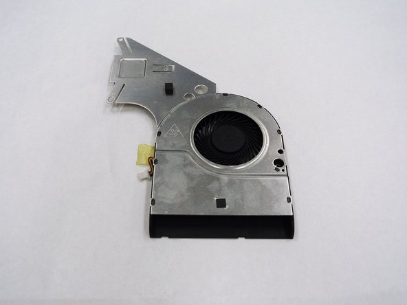

  15. Gateway NE51006u CPU Fan Replacement: crwdns2935265:015crwdnd2935265:01crwdnd2935265:03crwdne2935265:0 Gateway NE51006u CPU Fan Replacement: crwdns2935265:015crwdnd2935265:02crwdnd2935265:03crwdne2935265:0 Gateway NE51006u CPU Fan Replacement: crwdns2935265:015crwdnd2935265:03crwdnd2935265:03crwdne2935265:0
    • Use the PH0 screwdriver to unscrew the three 9.0 mm screws that are connected to the CPU Fan.
    • At this point of the process, the CPU Fan should be detached from the device.
