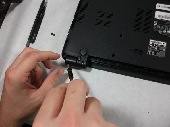

    1. Gateway MS2370 Screen Replacement, Screen: crwdns2935265:04crwdnd2935265:01crwdnd2935265:01crwdne2935265:0
      • Using the pointed tweezers, remove plastic circles that are stuck onto the back of the laptop’s hinges.
      • These plastic circles are stuck inside the hole with adhesive and might require a significant amount of force.
    2. Gateway MS2370 Screen Replacement: crwdns2935265:05crwdnd2935265:01crwdnd2935265:02crwdne2935265:0 Gateway MS2370 Screen Replacement: crwdns2935265:05crwdnd2935265:02crwdnd2935265:02crwdne2935265:0
      • Unscrew both of the 3mm Phillips 01 screws on both hinges using the matching screwdriver.

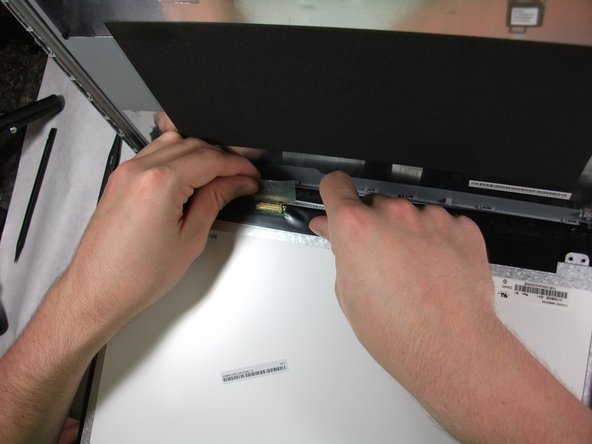

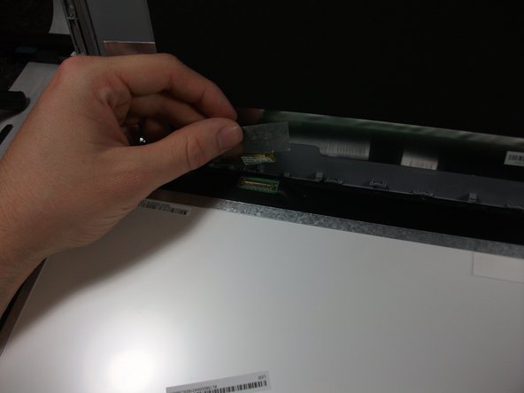

    6. Gateway MS2370 Screen Replacement: crwdns2935265:09crwdnd2935265:01crwdnd2935265:03crwdne2935265:0 Gateway MS2370 Screen Replacement: crwdns2935265:09crwdnd2935265:02crwdnd2935265:03crwdne2935265:0 Gateway MS2370 Screen Replacement: crwdns2935265:09crwdnd2935265:03crwdnd2935265:03crwdne2935265:0
      • Peel up the tape over the connector and unplug the screen from the laptop.

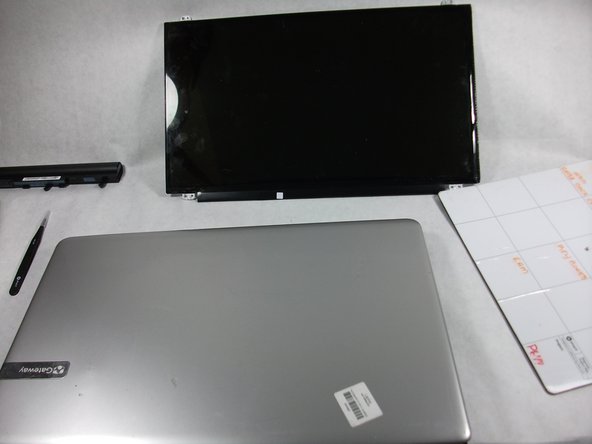

    7. Gateway MS2370 Screen Replacement: crwdns2935265:010crwdnd2935265:01crwdnd2935265:02crwdne2935265:0 Gateway MS2370 Screen Replacement: crwdns2935265:010crwdnd2935265:02crwdnd2935265:02crwdne2935265:0
      • Slowly remove the screen from the laptop.
