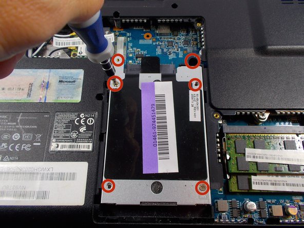

  7. Gateway MS2285 Hard Drive Replacement, Unscrew Hard Drive Cover: crwdns2935265:07crwdnd2935265:01crwdnd2935265:02crwdne2935265:0 Gateway MS2285 Hard Drive Replacement, Unscrew Hard Drive Cover: crwdns2935265:07crwdnd2935265:02crwdnd2935265:02crwdne2935265:0
    • Unscrew the six screws holding the hard drive cover in place
  8. Gateway MS2285 Hard Drive Replacement, Unlock Hard Drive Cover and Hard Drive: crwdns2935265:08crwdnd2935265:01crwdnd2935265:02crwdne2935265:0 Gateway MS2285 Hard Drive Replacement, Unlock Hard Drive Cover and Hard Drive: crwdns2935265:08crwdnd2935265:02crwdnd2935265:02crwdne2935265:0
    • Grip onto the cover and slide it away from the connector to release the cover and hard drive.
  9. Gateway MS2285 Hard Drive Replacement, Remove Hard Drive Cover: crwdns2935265:09crwdnd2935265:01crwdnd2935265:03crwdne2935265:0 Gateway MS2285 Hard Drive Replacement, Remove Hard Drive Cover: crwdns2935265:09crwdnd2935265:02crwdnd2935265:03crwdne2935265:0 Gateway MS2285 Hard Drive Replacement, Remove Hard Drive Cover: crwdns2935265:09crwdnd2935265:03crwdnd2935265:03crwdne2935265:0
    • Grip onto the black plastic tab to lift the end enough to get your fingers under.
    • Once it is high enough, place another finger or fingers under the cover and lift straight off.

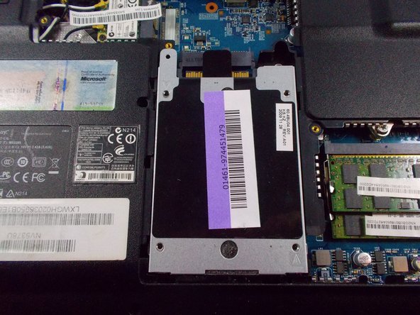

  10. Gateway MS2285 Hard Drive Replacement, Remove Hard Drive: crwdns2935265:010crwdnd2935265:01crwdnd2935265:02crwdne2935265:0 Gateway MS2285 Hard Drive Replacement, Remove Hard Drive: crwdns2935265:010crwdnd2935265:02crwdnd2935265:02crwdne2935265:0
    • Use hand to grab hard drive and remove.
    • Do not touch the gold connectors.
