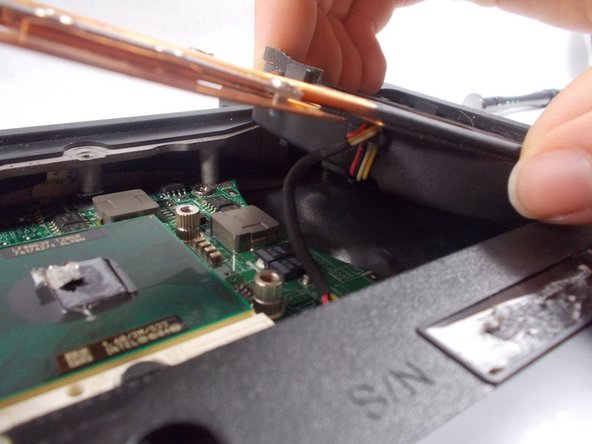

  5. Gateway MA7 Fan Replacement: crwdns2935265:05crwdnd2935265:01crwdnd2935265:03crwdne2935265:0 Gateway MA7 Fan Replacement: crwdns2935265:05crwdnd2935265:02crwdnd2935265:03crwdne2935265:0 Gateway MA7 Fan Replacement: crwdns2935265:05crwdnd2935265:03crwdnd2935265:03crwdne2935265:0
    • Lifting from the left side of the fan, start to pull the fan off of the motherboard.
    • Be sure not to pull the fan all the way off the motherboard yet. Before it can be completely removed the cables must be disconnected.
    • There may be thermal paste adhering the fan to the motherboard. Be sure to lift the fan slowly and gently.

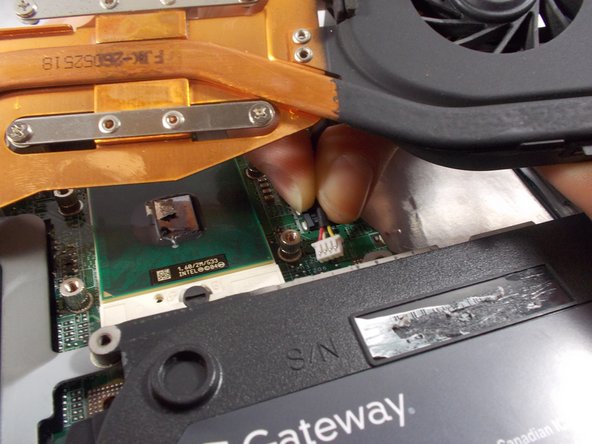

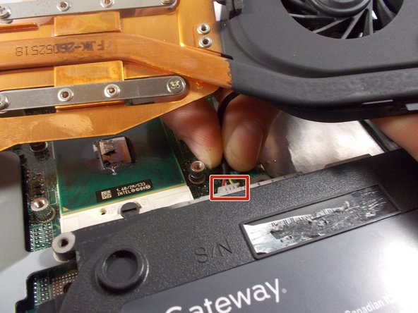

  6. Gateway MA7 Fan Replacement: crwdns2935265:06crwdnd2935265:01crwdnd2935265:03crwdne2935265:0 Gateway MA7 Fan Replacement: crwdns2935265:06crwdnd2935265:02crwdnd2935265:03crwdne2935265:0 Gateway MA7 Fan Replacement: crwdns2935265:06crwdnd2935265:03crwdnd2935265:03crwdne2935265:0
    • In order to properly remove the fan, disconnect the cable that is attached to the motherboard.
    • Gently grasp the connecting cable from under the fan and pull it out of the socket on the motherboard to disconnect it.

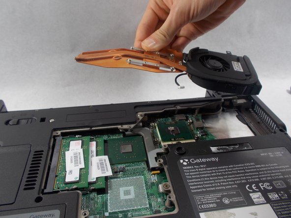

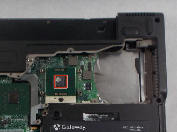

  7. Gateway MA7 Fan Replacement: crwdns2935265:07crwdnd2935265:01crwdnd2935265:03crwdne2935265:0 Gateway MA7 Fan Replacement: crwdns2935265:07crwdnd2935265:02crwdnd2935265:03crwdne2935265:0 Gateway MA7 Fan Replacement: crwdns2935265:07crwdnd2935265:03crwdnd2935265:03crwdne2935265:0
    • With the screws removed and the cable disconnected, just lift the fan off the motherboard to remove it.
    • When you replace the fan, be sure to reapply thermal paste here.
